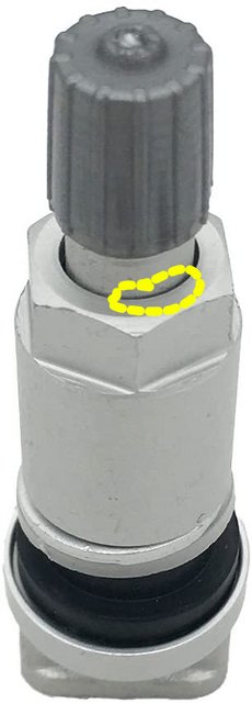

Daughters car.
She commented yesterday she had one tire that leaked down enough to give her a warning (maybe 5 pounds). VERY slowly... only about once every 4 to 6 weeks. She said two trips to the tire shop failed to find a leak.
I found it in two minuets after spraying windex on the valve stem. A super slow leak coming from the area I circled in yellow in the photo. I tightened the nut a bit ever so gently on the stem to no effect. Knowing nothing about these sensors I aired up the tire and showed my daughter where the leak was so she could show the tire tech next time.
So should it tighten up more or will it have to come out and resealed and or be replaced?
She says she may just let it leak and top it off as needed Roll Eyes I didn't particularly like that idea.
Yes. Tightening it more may well overtighten and break it. The nut is low torque to start with. If you're lucky, it can be resealed. Sometimes the sensor doesn't survive being removed and replaced no matter how carefully.

You could loosen the hex and there's probably an o ring under there somewhere but a new one (that requires partial tire removal) is likely what it takes to fix.
Unless it's a really expensive part, I'd take it to a good tire shop and let them replace it. Letting the tire get low and running it that way will cause all sorts of potential hazards and wear and it may not continue to loose air at such a small rate.

The batteries typically last 8 to 10 years, so you may simply replace. Check Rockauto, as they have service kits. Dependant on the make, may need a shop to re-sync / re-program. I recall the typical torque spec is very low. Easy to over tighten.

Most can be rebuilt with a new seal kit.

I had this problem when I got new tires and sensors from Costco. The tech said he had to remove the whole stem and installed new seals.

I have the valve stem that has the rubber seal....from 1990. From reading other sources, the valve stem can be tightened too much causing the seal to crack. In my case, it is probably age.

4 years old, an o ring kit should do it.
