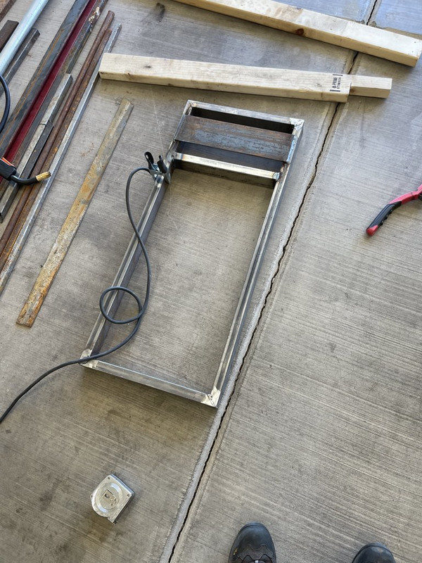

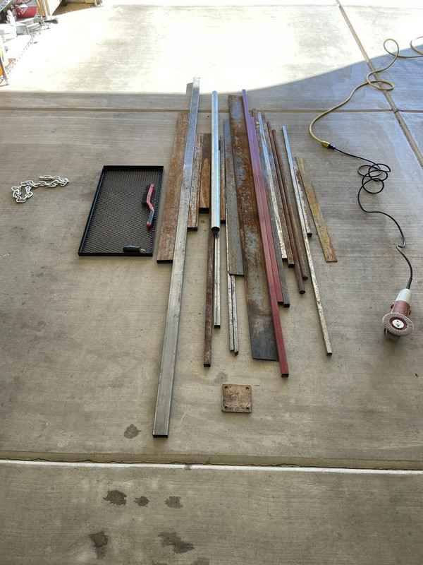

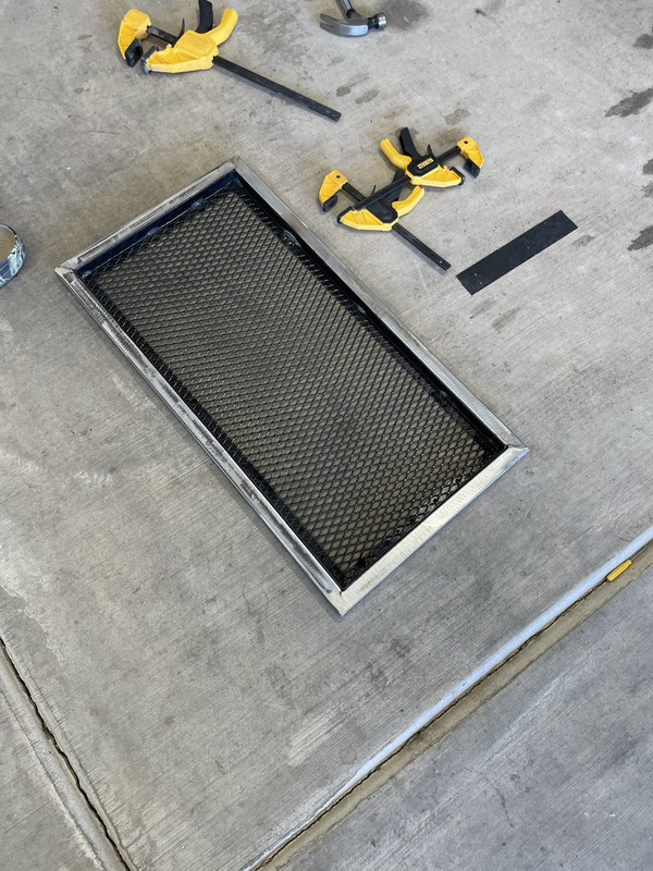

So I had bought the welder. Picked up a hood and a bottle. It was time to build a cart. My friend gave me a bunch of scrap steel he had (pretty nice as far as I’m concerned) and I had a shelf from my grill I had never used. Lots of cutting, some welding, and a little grinding and my cart is complete, aside of adding the bottom shelf.
I used to weld a lot when I was in my early 20’s. Started off with miles (yes miles) of iron fencing, six foot tall spear top. The landscaping company owner next door to our fence shop would come by and have us fix some of his stuff. We ended up doing quite a bit of fab work and a lot of repair work in Rowlett TX.
This was nice because it reminded me of what I like and what I don’t. I hate 16 gauge. Anything thicker is fine. I used my chop saw with a finish blade for wood, and it cut everything for the cart, aside of the solid cold rolled handle/cord minder.
I need to buy a saw designed to cut metal.

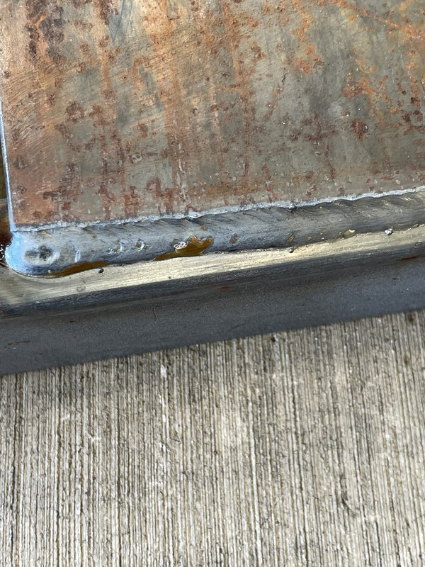

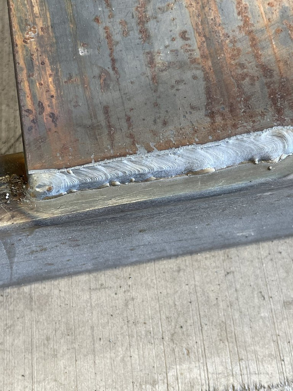

I’m quite happy with most of my welds. Some of the 16 gauge blew holes and I had to repair that. I dislike hole filling just as much as I remember.
All in all it was a fun day. I do need to buy a jacket as I have one hell of a good arc flash burn on my arms.

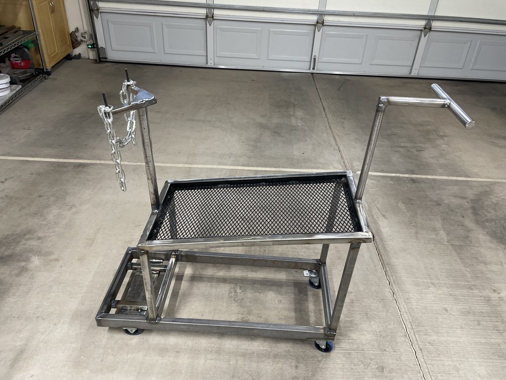

Question- why is the deck sloped?

Hey, I’m not trying to be critical and I’m obviously not an expert. But I used to cart around high pressure gas canisters years ago. We used very stable dollys that held the canisters at an incline toward the cart handles. That way they wouldn’t be prone to tip over forward or side to side. Is your tank counterbalanced enough?

Solid question Konata; Yes. The tank is actually pretty light. Maybe 40 lbs? The welder is 90 lbs and the handles on the cart weigh at least 20 lbs. The rear wheels are mounted right under the tank. (I would have mounted them behind the tank to add stability, but cost drove me to a cheaper wheel).
Russ, the slope on the Cart is so when you’re welding at a table, the mig torch tube is straighter. Keeps your wire flowing smoothly.
