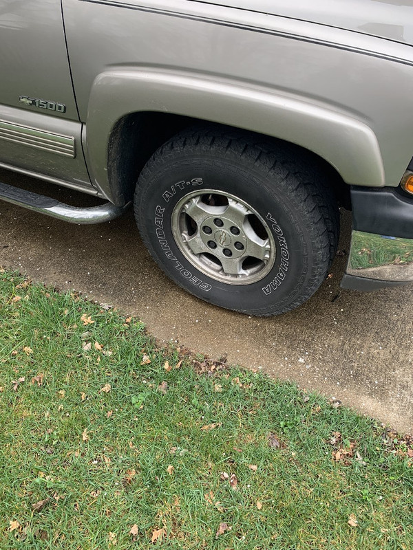

Funny you should ask. My Silverado has been sitting for a touch over a month because it won’t stop raining and I need to swap out the transfer case motor as it is stuck in 4wd.
Finally had a little break in the weather and the neighborhood came over to play out back where she resides. I noticed the ol’ Silverado was leaning a bit.
These tires are 8 or 9 years old (garage kept for 6 of those) and maybe 30k miles.
I would replace them. I was planning to replace these anytime now.
