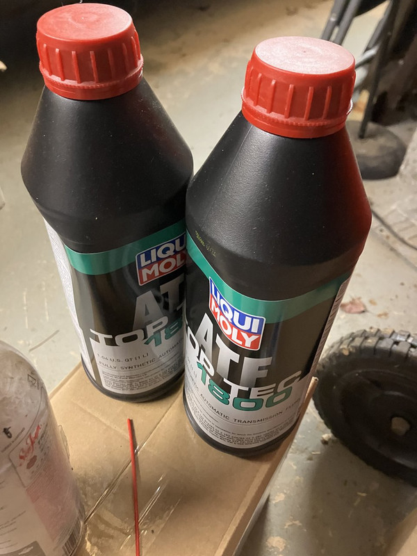

I can’t keep jugs of fluid in my shop anymore. I am probably out around $400 in detailing products and lubricants now.
The bottles will deform, sometimes they are sucked in like the top picture and other times they will be completely bloated the opposite direction. They will then eventually split at the seams of the bottles.
The newest craziness is I had two 5 gallon buckets with one stacked in the other. Last weekend I tried to separate them and I absolutely could not do it.
Today I went out in the shop and the outside bucket completely split up the side and not even at a seam.
What on earth is happening in my shop. What is causing these pressures to change so drastically that it causes buckets and jugs to split??

Temperature is steady and so is humidity. Stays between 50 and 70 degrees but there are never big fluctuations in temperatures.
It has happened with jugs that have never been opened and jugs that have been opened a bunch of times.
All shop walls are solid concrete including the ceiling. There is a door into the basement on one wall and a garage door on another. Three sides are below grade back wall is not.
Ceiling is fully insulated as is the garage door. The shop is not wet and I keep it around 50% humidity.
My upstairs garage has much larger fluctuations in temperatures and I have no issues like this.

The buckets are easy to explain, gravity gradually forces the top one down into the bottom, when natural day-night temp. fluctuations occur, the bottom one splits. if you can somehow maintain an air gap between the bucket walls, it should do the trick. I have had buckets nested so tight they were almost impossible to separate.
To investigate further on the bottles, fill one with plain water and set it along side one with a history of splitting. Another with a very volatile liquid, e.g. acetone, might provide another data point.
Are the contents particularly volatile? If you won't lose too much product, vent the tops on some to compare results.

So far I have lost 2 separate gallons of car soap, one gallon of fabric and carpet cleaner.
Brake fluid, ATF, Dexron, jug of Fast Orange. Over the last 5 years or so.

Oddly (to me), panelling is the term used to describe bottle shrinkage/collapse - often to the point of rupture. Slight changes in the composition can affect this and often times the end product manufacturer is unaware of these changes. Most companies that make liquid products purchase containers from a molding company.
Here's a bit more info: Panelling of Plastic Bottles

I had the exact same problem until I started putting a single paint stirring stick vertically between each stacked bucket. Viola. Works perfectly. Duh on me, I had to read about it on the internet.
