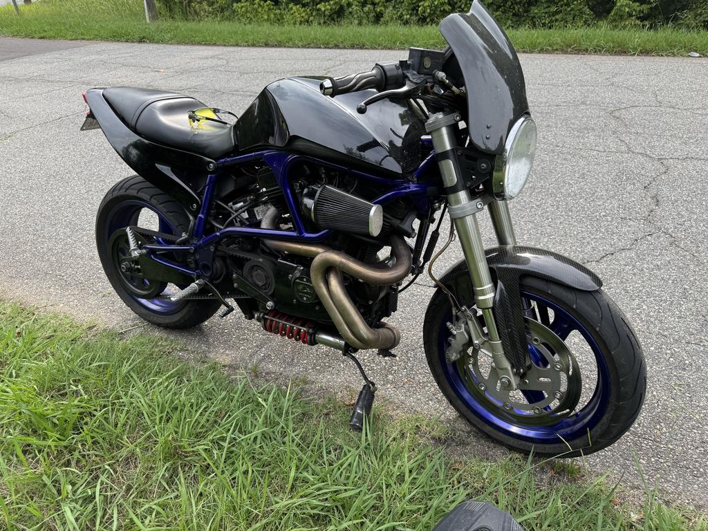

I own a few motorcycles so today I wanted to take my favorite one out for a ride, I was in a BAD mood and needed to clear my head.
I am NOT brand loyal (though I root for Aprilia when it comes to moto racing) and I have to say hands down the most fun AND most problematic motorcycle I own is my 2001 Buell X1 Lightning. It’s been to the shop WAAAAAAAAAAAAAAAAAY too many times. Electrical issues…transmission issues… starting issues…ignition issues….etc. But it provides a ride experience that my BMW & jap bikes cannot emulate. When it decides to not be a piece of totalshit it is incredible! Rowdy as fuck and fast off the line like a GD rocket.

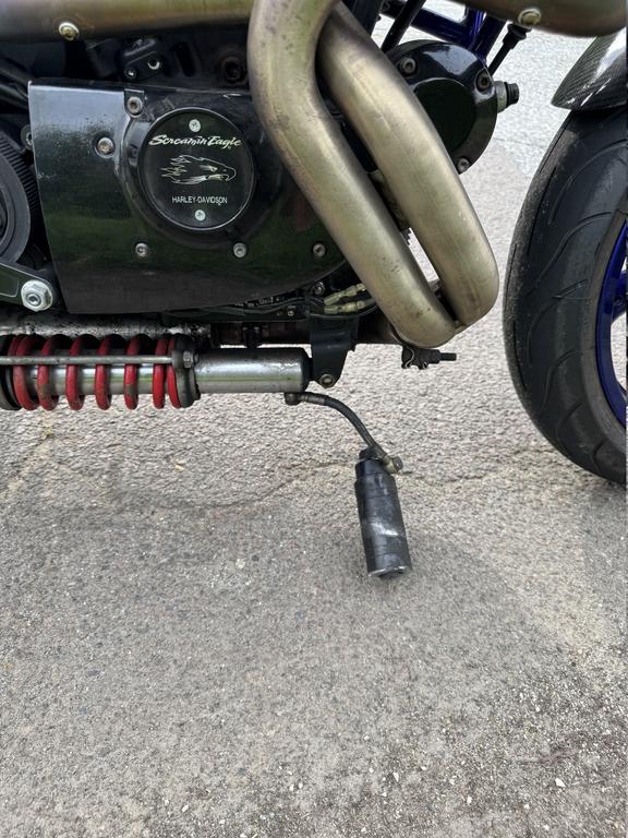

Today it was actually running REALLY GOOD so imagine my shock when a Volvo rolled up to me FAST and rolled its window down and the driver kept pointing to the ground enthusiastically…
Thank you man!
I love her soooo much but she don’t love me back…. Our relationship reads like the lyrics to a damn country song… Frown This bike hates me.

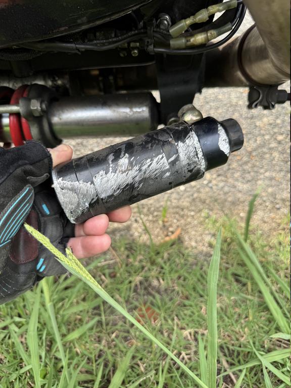

It is a shock reservoir, which is an auxiliary chamber attached to high-performance shock absorbers (cars/trucks, motorcycles, and mountain bikes) that holds extra damping oil and pressurized nitrogen gas.
It’s an almost impossible part to replace (on this bike) so grinding it on the road is less than ideal…. Frown
Compatible aftermerket replacement shocks I’ve found cost about 1/3 to 1/2 the cost of the bike so this is most unfortunate.

I'm thinking a reservoir is a reservoir. The valving is in the shock body. I think the reservoir just has a piston with a seal between the oil and nitrogen, 'cause you gotta keep'm separated.
Edited to add:
Nope, I'm wrong. It's got a bladder instead of a free floating piston, which means if the housing isn't cracked and/or leaking, then it should be fine. The rebound damping is in the reservoir cap, but shouldn't have been affected.

A couple of zip ties, and a can of black Rustoleum, and you are back in business.
Or, just tell people you're rocking a custom one-of-a-kind kickstand!

Uuugh...I hate when that happens. At least it was obvious. I've had this happen, including other types of waving, flashing lights, etc. Then I pull over and can find nothing wrong.
Sucks about your bike! Was the reservoir intact and functional other than cosmetically? I'm not a biker, too, so my understanding of this is limited. I'm only familiar with such reservoirs on off-road truck suspension for the extra travel they provide.
