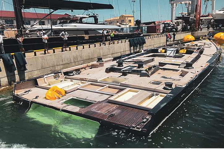

The second image looks like she's a total loss.

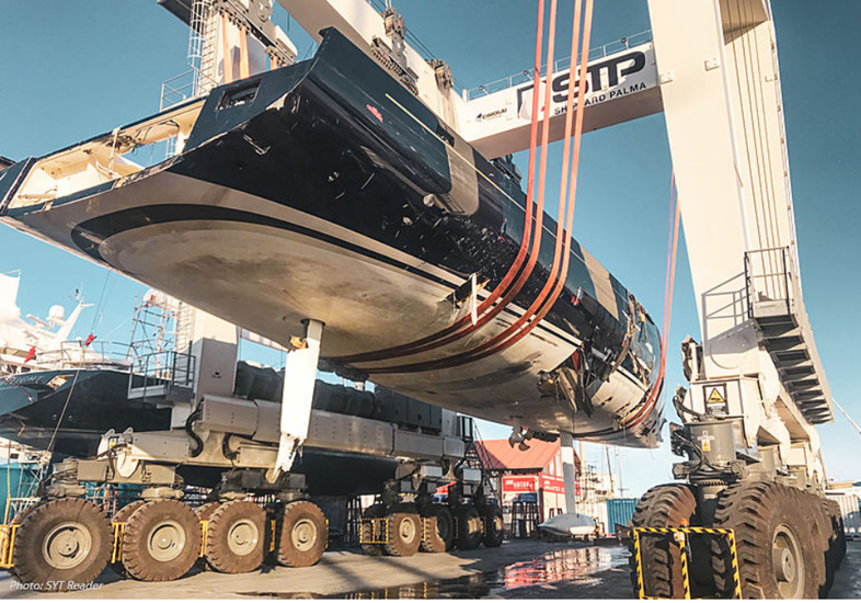

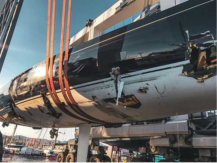

    They towed her to Pallerma and hauled her out of the water. She was partially submerged for the entire voyage. She should be a total loss from the looks of it and the cradle punched several very large holes in the bottom of the hull. So either the lashings got loose and she was bouncing heavily on them, or improperly supported by the cradle which allowed the cradle to punch holes, create slack in the lashings which snapped them and off she slid into the ocean. It's a shame.

    Jimmy implied there were pics. Here are some:
    https://www.superyachttimes.co...ong-hauled-out-palma

    Someone heavily involved in the yacht shipping industry reported to me that the same loadmaster, was the same loadmaster that lost 2 yachts (a 30 meter and 40 meter) off of the ship BBC Utah 2 years ago. Several people are saying that this one is/was under strapped and the straps didn't have enough angle. I'm not sure if it's factual or not, but from all of the yachts I've seen strapped, they usually have twice as many lashings.
