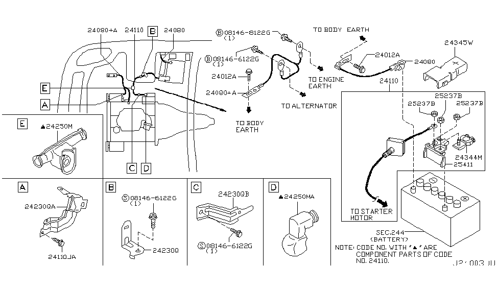

HRK
Infinity g35 (2003
Wiring Diagram from Battery, may help you trace the problem, more at the link
The Link
