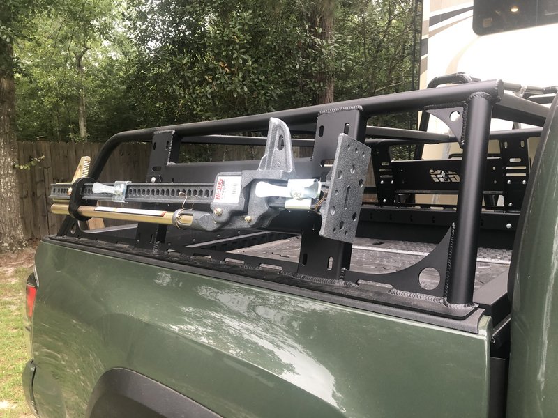

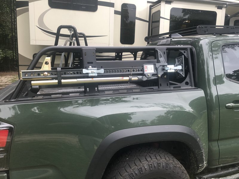

Well, old dog, new tricks. Anti-seize worked. Although all I could think of is the pic someone posted here a while back of an air force guy glittery from head to toe with anti-seize.
Here is the final result - the bolts holding the brackets to the bed rack:
