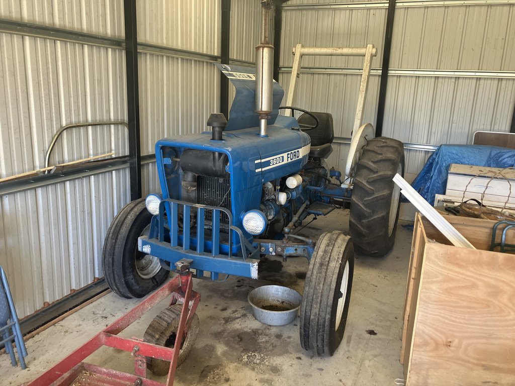

Alright my tractor friends, let’s get this old Ford 3600 started!! UPDATE: Ford: 1 - Me: 0 Login/Join
Raised Hands Surround Us
Three Nails To Protect Us
Picture of Black92LX
I don’t know much about these things beyond starting and driving. The damn thing just always started and ran. So don’t rip me too bad if these are dumb questions.
Been sitting in the barn for about 5 years now (yeah I know, I know).
Going to drain out the old diesel and put on a new filter, add new fuel
New oil and filter
New transmission, rear, and hydraulic system fluid, and filter.
Top off power steering fluid
Grease all the zerks
Charge the battery (guessing it will need replacing)
Gravity Bleed the fuel system starting at the filter then to the injectors.
Then comes the actual starting attempt. What should I do here since it’s been sitting so long? Presume I just don’t want to go cranking it with the starter.
As for the battery. It’s a massive 4DLT wet cell battery. I assume battery technology has come a ways since the 70s. Should I stick with a 4DLT or is there something else I should go with?
I don’t have electricity in the barn so the battery is likely going to be taken out and go with me to keep on a tender.
Though I may very well get a solar tender and not have to do that.
What am I missing in my thought process and/or what is wrong in my thinking here.
I ordered a repair manual that should be here in the next day or so. So I will know all the specific fluids and their capacities along with filter and grease type.
I have watched a number of videos and all seems pretty straight forward.

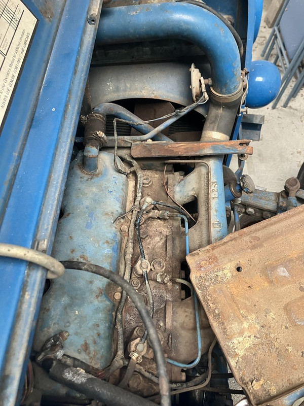

Fluids, filters, fresh battery and light it up.
Shouldn't need to bleed the fuel system as it hasn't been apart.
For that I just crack a fuel line loose at the nozzle and crank it till fuel comes out, one at a time.
Those things will run on most anything and are pretty hard to kill, I've pre-filled filters with ATF when they have been run out of fuel to get them going in the field.

Engine oil and filter definitely.
Fuel and filter probably. Visually check the tank for rust and water. Condensation from temperature swings will build up moisture in the strangest places.
Other fluids, I'd just crack the plug and check for water. If you get water, then change fluid and filter. If not, then run it for a while and change after it's had a chance to stir up the sludge.
Other than that, I'd crank with the fuel shut off to distribute some oil around. If it has an oil pressure gauge, see if it will crank enough to show pressure on the gauge.

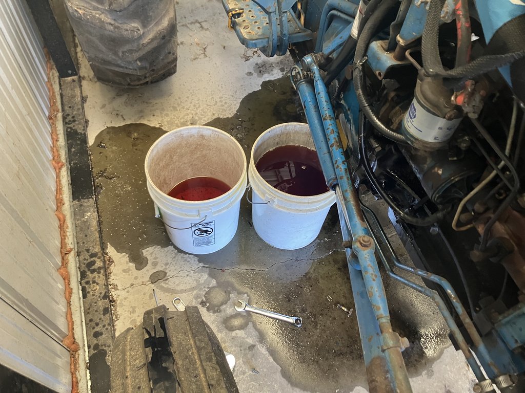

    So I gave NAPA a try and was able to get Fuel, Oil, and hydraulic filters Oil and Hydraulic made in the USA Fuel filter in Mexico.
    Went to tractor supply lastnight and got some oil, coolant, hoped to get some StarTron Diesel treatment but they were out. Figured I would hold off on the hydraulic fluid as suggested since I need 10 gallons.
    Well had the day off today and headed down to the cabin. Pulled the battery and put it on the charger. I have been watching a bunch of YouTube videos about old Fords and man all those tractors look like hell. Mine is a 1977 3600 with 2200 hours (if correct) and looks way better than those in the videos. So I am convinced I am going to get this thing running. Fortunately it has been stored in a barn with a concrete floor for 15 years and under a cover on gravel for 10 years before that. Not sure about the prior owner(s).
    Need to take the battery tray off and clean it up and repaint it. It’s pretty much the worst part of the tractor.

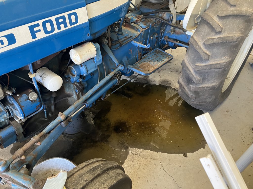

    Figured I would start the fluids by draining the fuel. Disconnected the fuel line from the shut off valve, placed my funnel under the shut off valve and aimed at my bucket. Unscrewed the petcock and not even a single drop, stuck a screw driver under the clip to fully remove the petcock, and unfortunately broke the lip off but was able to pull the petcock out and still not a single drop. One video I watched said their was buggered up so I just unscrewed the whole valve.
    HOT DAMN!!!!!! It was like Niagara Falls and WAY out flowed my funnel. Got about 6 gallons in the buckets and probably 4 on the floor.
    The diesel was super clean pretty much. I chunks or rust came out. The tank looked like it had a black film over the whole thing after drained but nothing in the buckets.
    Should I try to clean the tank somehow while I have the valve out?
    In the tank there appeared to be a sock that would have slid over the strainer on the valve I presume but did not take my grabber so I could not get it out.
    I could also see what looked like a shepherds hook that was coming from where the gauges are so I am guessing that would be for the fuel gauge but seems like it should have some sort of float on it or something.
    I made a wall of paper towels to keep the diesel contained and ran out to get some lunch and cat litter.
    Came back put out the cat litter and checked the battery and it was stuck at 1.0 volt so at that point I figured I would call it a day.
    What are the chances of finding an actual Ford shut off valve?
