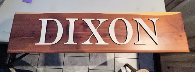

A Grandson made me a family name plaque for Christmas, said for me to hang in my man cave / den / TV room.
I thought I might hang it over the mantle. Easy enough...
...but then I had the idea to perhaps suspend it off the wall an inch or so and backlight it with LEDs to create an even but subtle glow around it.
Knowing little of LED strips I thought I'd ask the collective... I need specifics if possible please.
Battery powered would be a pretty big plus but not a deal breaker and a remote to turn it off and on desirable. It won't be "on" all that much, I expect when guest are over perhaps. If powered by mains I might even put it on a timer with a dimmer... There is power above the mantle near one end and a dark cord would be hardly noticeable if needed. Oh yea, selectable color would be nice
It is ~32 inches long and 8 inches high, a ~inch thick cedar board.
Think soft glow, consistent all around, not bright.
I think the light would need to be hidden/shielded from direct view form the sides by a border or trim inset behind the plaque... or perhaps a led strip could be routed into the board to hide it.
What y'all think?
