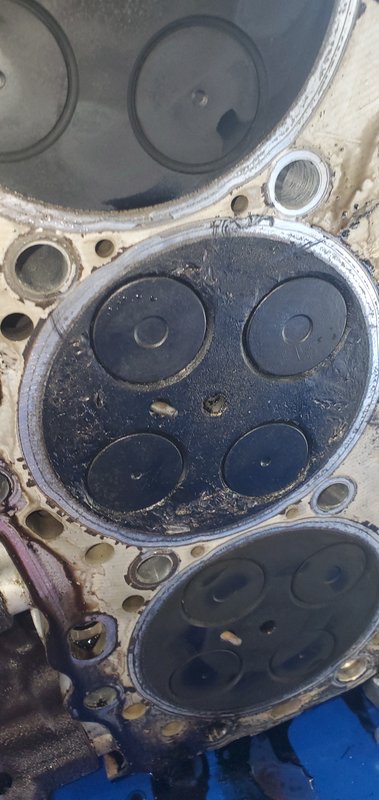

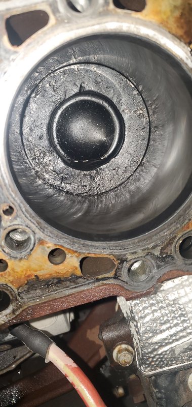

Pics the damaged piston and the piece of metal they found.
Posts: 7511 | Location: Raymore, Missouri | Registered: June 24, 2006Reply With QuoteReport This Post
The top pic is actually the combustion chambers and valves in the bottom of the cylinder head. It's unusable - there is severe gouging around the perimeter of the combustion chamber where the head gasket "fire ring" seals. The piston will look much worse, I'm sure.
Missed including that one. Post has been edited.

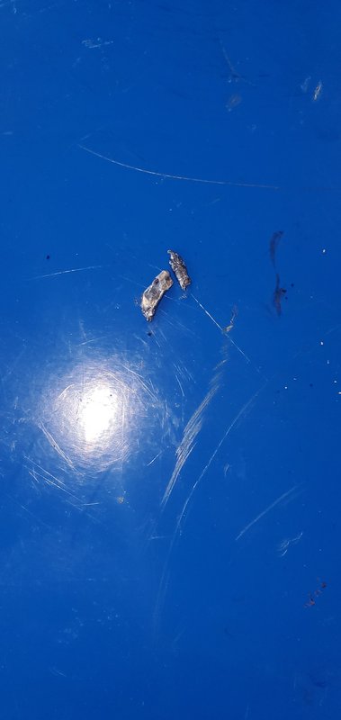

I'm no diesel mechanic.....
Where's the metal that they found that caused the damage? Those metal pieces look to be what was gouged out of that piston, and not like what I would expect to cause the damage seen. The cylinder walls do look in pretty good shape. So do the heads and pistons minus the impact damage.
So.....where's the piece that caused the impact damage?

Based on the pictures posted after your post, I don't believe that's what happened here.
One, Walker77's dad's piston is not cracked.
Two, the cracked pistons from a CP4 failure are because tiny bits of metal from the failing pump jam an injector open flooding the cylinder too much diesel. The excess fuel doesn't compress or ignite like normal and the piston cracks.
Three, the chunks of metal in the pictures look too large to have come through the injector.
The question now is where did the metal come from?

There are other possibilities that are easy to eliminate. The tip of the glow plug for example which in this case is clearly intact in the cylinder head photo as are the valves. The tip of the injector or a valve seat are other easily eliminated possibilities.
After that, we come back full circle to the work the dealer did replacing the EGR assembly which opens a clear path to the intake manifold. Truck worked fine before that, and then blew during the test drive after the work was completed.

Looking at the head it appears like the top left valve is cocked a bit the inside looks down in the seat and the outside edge looks up. Compare it to the others which have a different color and that cylinder looks black. Metal may have got under the open valve and bent it or came out of it?

I'm trying to understand how the piston head surface looks like a melted lava cake.

Then it should follow that we'd see damage in more than one cylinder since the fuel pump feeds all cylinders. This appears to be a single cylinder damaged.
I guess it's possible the fuel pump tossed off some metal and it went to #5 only, but doubtful. Piston looks damaged but intact,
It's odd that the cylinder walls appear to have zero marks...
Diesel pistons have a large recess with a raised part in the center, the black is probably carbon built up or camera angle or both.

One of the valves shows some evidence of impact with whatever was ingested into the cylinder and it also appears that the valve in question 'may' be bent and not seating/sealing properly. This would result in incomplete combustion and unburned diesel fuel on the surface of the head and piston. Further, whatever was ingested into the cylinder was repeatedly being smashed between the piston and the combustion chamber of the head, so they look a little 'beat to shit' as a result! Wink

^^^If it was something that 'simply failed' they NEED to produce the part in question. Chunks of metal don't just get into a sealed intake system and ultimately the cylinder/combustion chamber! Just prior to the 'failure' their service tech had replaced the EGR.
As previously posted by 'trapper189' - "Removing the EGR valve opens a path into the center of the intake manifold and cylinder 5 is one of the 4 central cylinders."
Per a previous post by the OP - "I just got off the phone with dad and got some clarification. The (independent) diesel mechanic he talked to said he believes the dealership dropped a bolt in the cylinder when taking off that def valve. Said he had seen it before."
If they want $7900.00 they NEED to produce the failed part, period!

Why do you guys think they opened that motor up prior to the OP and his mechanic showing up per their agreement?
They found the cause, and that cause found its way into the nearest trash can before anybody else could see it.
