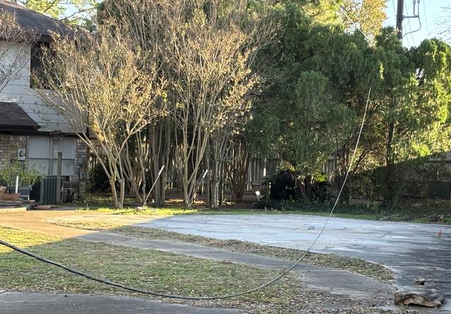

Here is the frustrating story. Back in about mid-November, some sort of utility crew was working on overhead lines right behind my backyard fence. I didn't pay much attention to them. The next day, I noticed one of the lines was now touching down to my backyard's ground. The crew came back a few days later supposedly to complete whatever they were doing. I saw the line was being pulled on, so I thought they were going to raise it back up, so I went on about my day. Later on, when they have left, I looked out back and the goddamn line was still in the exact postion as it was. WTF? And these jerks never retured again.
I clearly had no idea about the nature of this line. First thing came to mind was powerline. So, I called Centerpoint Energy. They came out, checked and nope, it's not a powerline. It's a telecom line, they said that could belong to AT&T or Comcast/Xfinity. There are zero markings to help identifying which company it belongs to. Called Xfinity, they came out and nope, not theirs. Called AT&T, they came and nope, not theirs, either. They say it's fiber cable but whom they belong to is a mystery. And, apparently, this is a nonfunctioning line. Whatever they did, it ends in a coil just stuck to the pole by my backyard neighor's house (first pic). The line crosses his backyard, crosses his tree by our shared fence, drops all the way down to the ground in my backyard and then goes back up to the next pole and continues on...
For perspective, the real powerlines are way up higher out of view.
I'm at a loss as to what I can do next. Suggestions, please.

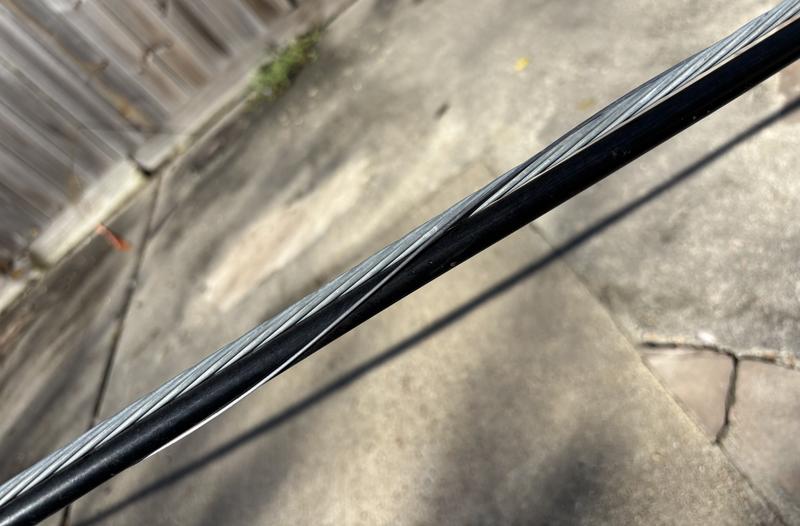

This is the close-up pic of the line. You can see it's actually made up of three distinct line, the bare metal braided one, the thin metal wire and the black plastic/rubber covered cable.

The metal braided cable is a tension line that is designed to keep the wire from sagging. Obviously some connection broke somewhere.
The bare metal (steel) line is for carrying the weight of the other two, it will have a strain relief at one or both ends that attach to a fixed structure (the pole or the house). The strain relief may have slipped it's J hook, or more likely, corroded through.
The thin metal line is for lightning protection. Probably zinc-plated copper.
The insulated line is the data line, could be twisted pair, co-ax, or fiber. You might be able to tell which by examining the box it is routed to on the house end, or by closely examining the line itself for any printed or embossed markings.
