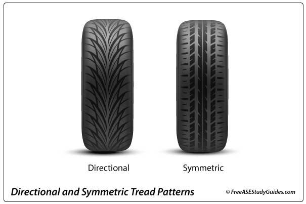

Some tires are directional. Meaning that the tread pattern is designed to run one direction.

Depends on the tread design and carcass (the internal cords) construction.
Asymmetric treads are that way. These are usually tires that are more high performance than your everyday sedan or minivan/SUV.

Directional tires push water in a specific way. Pretty common. All my motorcycle tires are directional.

There's also non-directional tires that have a marked OUTSIDE on the sidewall. Could've been the case of the OP, if they weren't directional.

For some directional tires, I imagine it could funnel water inward & cause increased hydroplaning.

Directional treads can still be symmetrical and not have an inside or an outside, but they have to rotate in the proper direction. So there is a correct orientation for the left side and for the right side and you can only rotate front to back. Driving with them rotation the wrong way will pull water into the V of the tread rather than out. Not a good thing
Asymmetrical treads have an inside and outside and are marked that way on the sidewall. But they are not direction and once mounted properly on the wheel, they can be placed at any location and can be rotated with a cross pattern.
Asymmetrical & Directional tires have to be made for left side and right side as mirror images, installed correctly on the rim, and only rotated front to back, assuming they are the same size. Only very high performance cars use this kind of tire, and the rears are often larger than the fronts, which means you can't rotate them.
