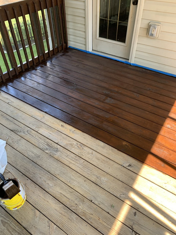

Mixed it in a pump sprayer. Couple spots I had to use a deck brush to agitate it pretty well befor power washing. I did a light power wash green nozzle. The same I use in my vehicle so it did not gouge or damage the wood.
I was shocked at how well it worked. It was a craptastic job as I also removed all the railings and replaced all the screen.
Next time I will make it an enclosed deck/sunroom thing because I am never doing it again.
I used Cabot Mahogany stain and it’s a great color with two coats. It has held up very well. This was summer number 2 we have a dog and deck chairs that slide all over it and it still looks great.
