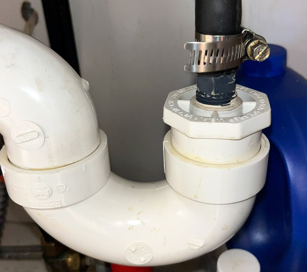

I need to change out the fitting under my kitchen sink for the dishwasher drain hose, which was 1/2" but is now 3/4"
Looks like the PVC is standard 1 and 1/2" so I need a fitting/adapter/whatever that's 1.5" x. 75" and I need to get it PDQ. I looked on Home Depot's site but there are so many options, I can't seem to find it.
Can anyone find this fitting on HD's site? (and hopefully,it will be in stock for me locally)
Also, what am I using to seal the connection in the 1.5" pipe? Plain old white plumber's tape, or what?
I imagine I can unscrew this with just channel locks, right?
I can find a plumbing supply store around here if I need to but I'm hoping HD has what I need. Thanks

The dark gray piece will unscrew, but the white PVC part it’s screwed into is glued to the elbow. The whole trap appears to be glued (solvent welded really), so you really can’t just replace the female thread part by itself.
Otherwise, I think this is the part you are looking for: 1-1/2 in. x 3/4 in. PVC Schedule 40-Reducer Bushing SPG X FPT.

Just get an adapter to go from 3/4 to 1/2 and hook it to the same spot. Leave the pvc alone.
Posts: 913 | Location: Alabama | Registered: January 05, 2005Reply With QuoteReport This Post
So, the adapter would be 3/4 to 1/2 with the 1/2 end being female threaded. The 3/4 end would be unthreaded or it doesn't matter, correct? Where do I find that part, and can I seal the connection with plumber's tape, or what?

Here's a link to HD's web site with the reducer that I think should work for you.
Try to grab an employee and he should be able to get you exactly what you need.
Depending on the type of fitting on the end of the 3/4 hose, you may have to glue a short stub of 3/4 PVC pipe to the reducer so that the clamp has something to attach to. (you may need to pickup some PVC glue and cleaner while there).
https://www.homedepot.com/p/Ch...HD/203825580#overlay
I would also recommend that you hold the octagonal fitting when loosening and tightening the fittings, you'd don't want to tweak the glued parts of the trap.
ETA: Good luck and let's hope that you get it done with only one trip for supplies.
