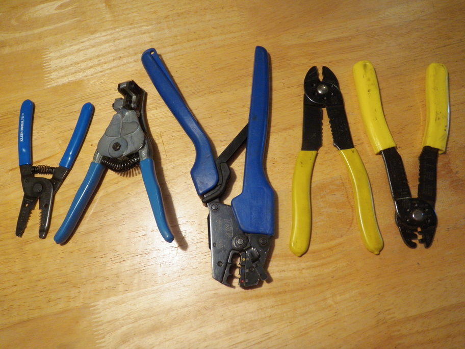

Ok, here we go: All Most People Would Ever Need To Know About Strippers And Crimpers (I think).
L-to-R: Klien strippers, Ideal Industries Stripmaster® "automatic" wire strippers, Thomas & Betts Sta-Kon® (ratcheting) barrel terminal crimper (calibrated), Vaco barrel terminal crimper, Waldom open-barrel (aka: "U") terminal crimper.

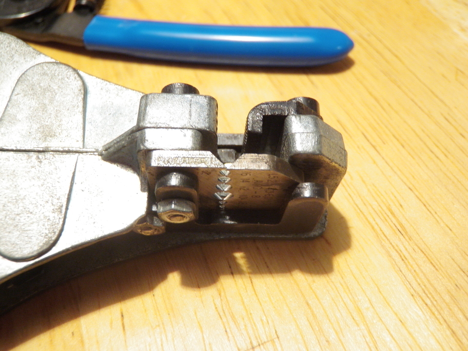

Experiences and opinions: The Klien strippers work well, but, if you have the room and wire length, the Stripmaster® stippers are unbeatable. They precisely cut the insulation, automatically grab it behind the cut, and neatly pull it straight off, all in one smooth motion.
Here's a close-up of the Stripmaster® jaws, partly closed:

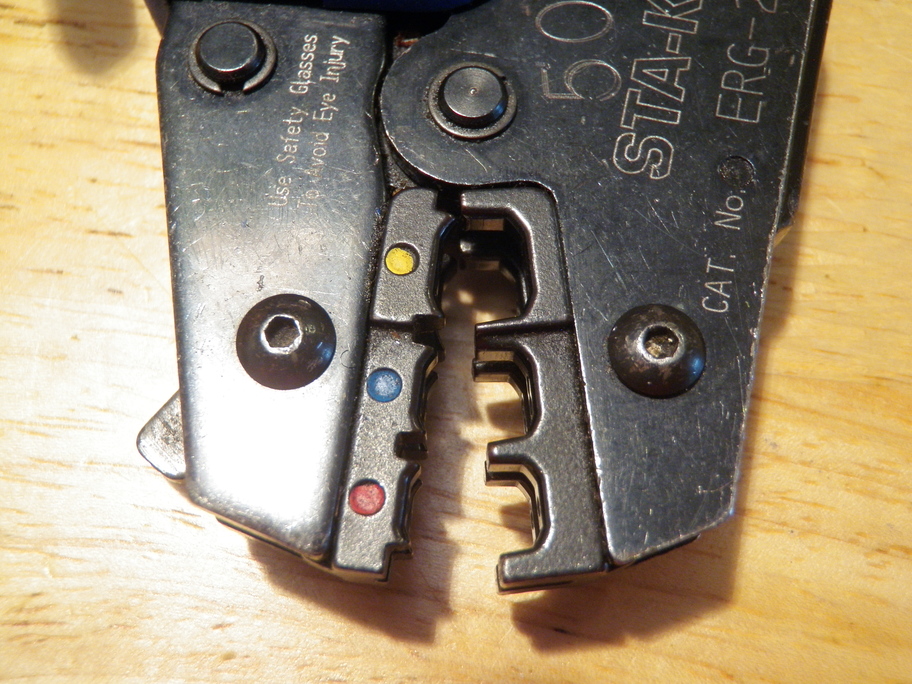

For crimping barrel terminals a calibrated ratcheting crimper, such as the T&B, above, is best. They will precisely crimp both the connection and strain relief in one go. As much as necessary, but no more. Alas: They're expensive (±$200) and are sensitive to wire gauge, insulation diameter and barrel size.
Note the colour-coding.

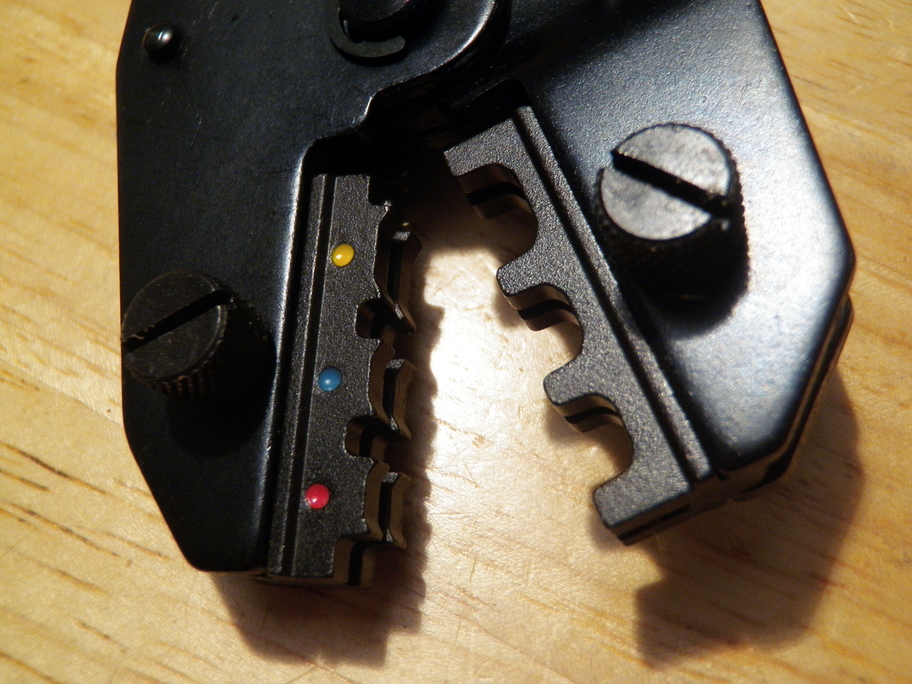

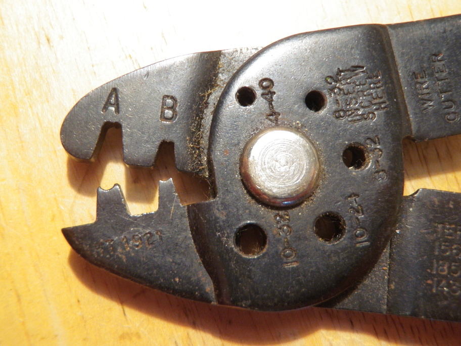

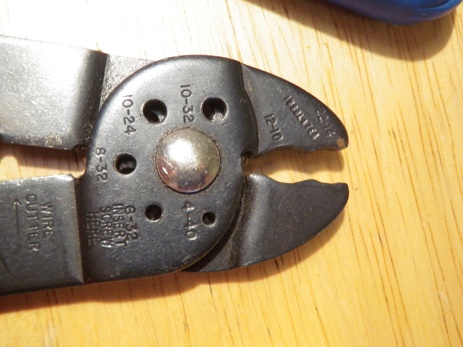

Of particular note: People often confuse barrel crimpers with open-barrel ("U") crimpers. Close-up of barrel crimper jaws:
Close-up of open-barrel crimper jaws:
DO NOT use these on barrel terminals. They're meant to be used with open-barrel terminations, such as the pins in Molex connectors.

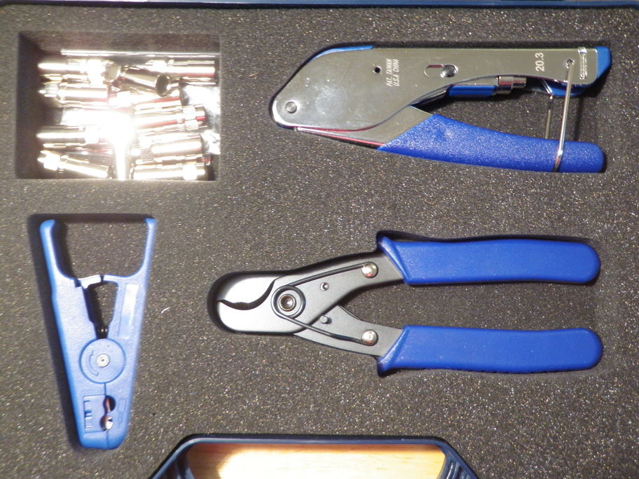

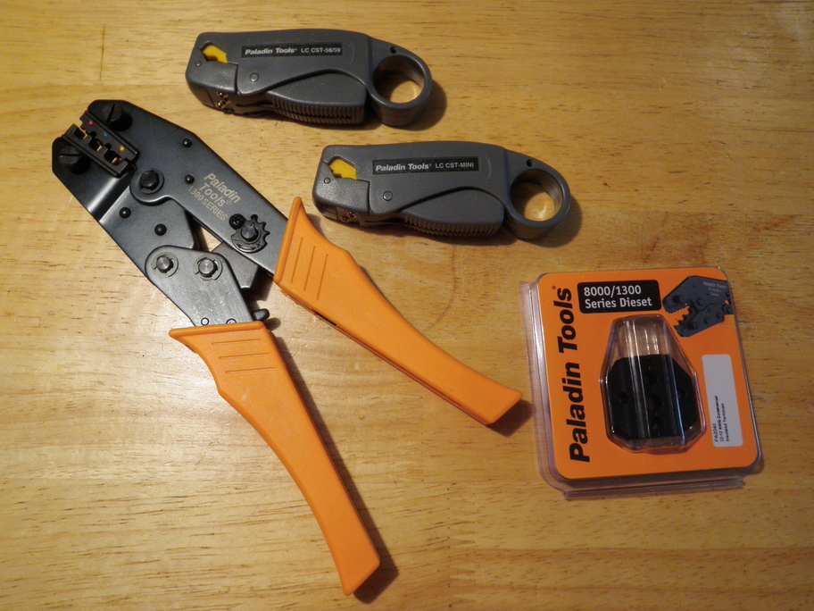

Coax. What most consumers will encounter is RG-6 and similar coaxial cables, using Type F connectors. The absolute best way to deal with these is a Paladin DataShark compression termination kit:
This particular one is designed to terminate everything from RG-6 through RG-6 Quad-Shield coaxial cable. Clockwise, from upper-left: Connectors, compression crimping tool, cable cutters and strippers.
I've been terminating coaxial cable of all types for 45 years. Trust me when I tell you: For F connectors and RG-6 this is the only way to go.
Something few consumers will ever have to deal with, but, since I'm doing this...
L-R, top-to-bottom: Paladin ratcheting crimper, stripper for RG-58 and RG-59 coaxial cable, stripper for sub-RG-58/59 coaxial cables, second set of crimping dies for the crimper.
Close-up of one of the die sets:
This set of tools is a highly-specialized set used to terminate coaxial cable using crimp BNC and TNC coaxial connectors. (Both the pins and the shield/strain-relief barrels.) It's tricky to get the hang of, but, once you do, much easier than the solder-on pins and compression collars traditionally used.
Like the T&B ratcheting barrel crimper, above: Expensive and each die is designed for specific wire gauges, insulation diameters and barrel sizes.

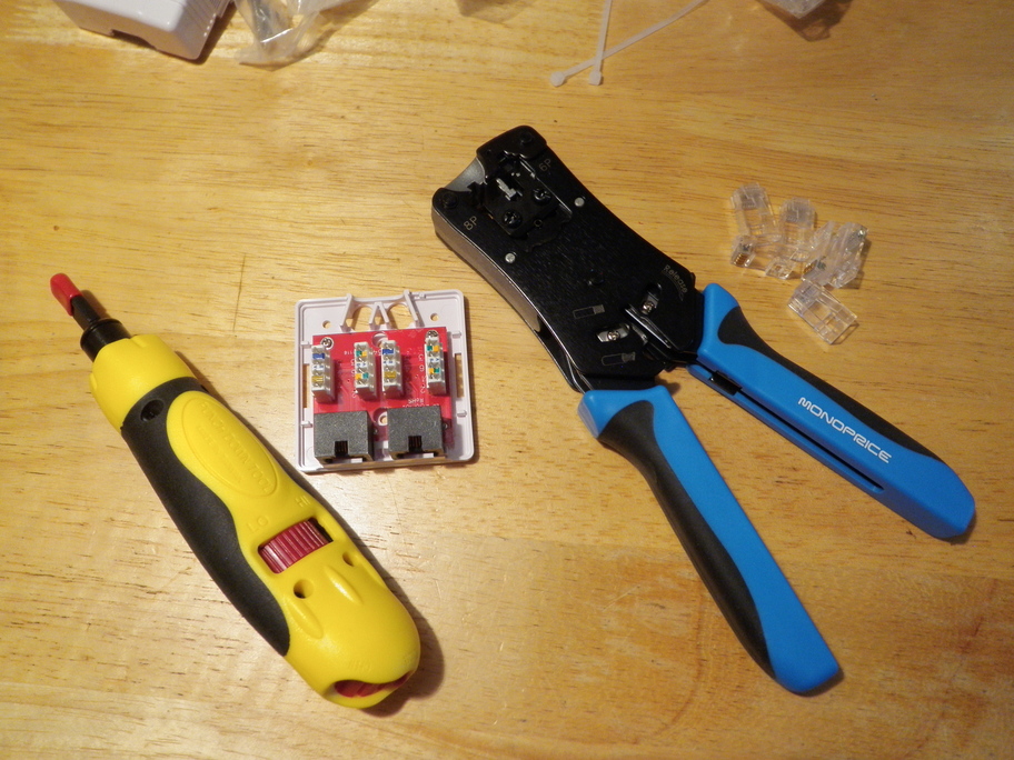

As I was putting the preceding stuff away, I remembered the networking and phone stuff:

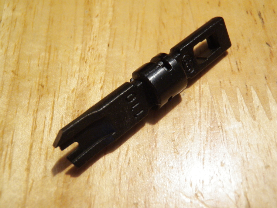

L-R: 110 and 66-block punch-down (or "punch block") tool, duplex surface-mount UTP network jack with 110 punch-down terminations, an RJ-11/-12/-45 termination tool and some RJ-45 modular plugs. (All Monoprice.)
Close-up of punch-down tool heads (66-block on upper-right, 110 lower-left):

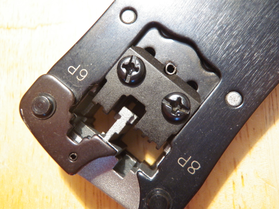

Close-up of RJ-series modular plug termination tool head:
(RJ-11 [4-pin] on opposite side.)
