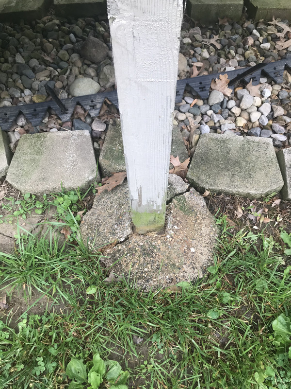

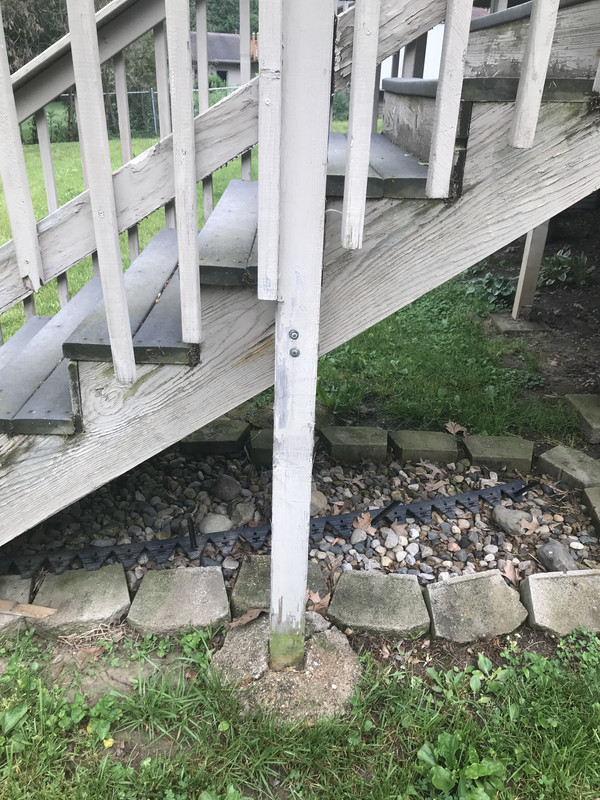

I need to replace both of the picture posts, both of the footings are cracked. I was going to break out the footings and replace the posts. Whats the easiest way to attach the posts to the footings, There is a base that goes into the concrete when its wet and a post that bolts to the footing. It seems that the bolt down base would be the easiest. How long would I have to wait once I poured the concrete to bolt the footing base down? Is there a better way?

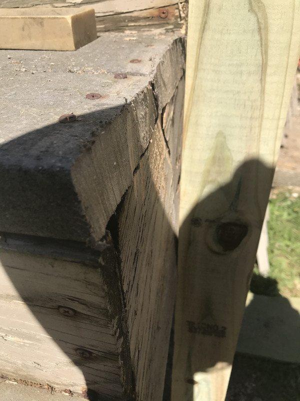

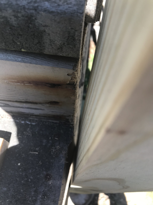

Update- old footings out, new ones poured, with the new post plumb there is approximately a 5/16 gap at the top of the stringer. Should I shim it? Put it together with and not worry about the post being plumb? Suggestions? The stringer isn’t plum .

Replace the concrete footing but don't bury the post. Place the post on a base lie below to keep it from rotting out.
The easy way is to repour the footing first. Let cure for a couple days and then drill in an expansion anchor. Secure the Post Base to the expansion anchor and then set the post.
Simpson Adjustable Post Base
I have used this as well, but in response to your question (rightly or wrongly) I have only ever taken up part of the old concrete unless it was literally crumbling, in which case it all needs to come out. Taking the rotten wood out of the center is imperative, and all of it needs to come out. I usually only go down a foot or so into the concrete if it is in decent shape, and leave the old concrete below that point.
Where the old post was I pour fresh concrete to the bottom, and then top it off with the above post mount, making sure the wood does not contact the cement.

Last time I did it, I replaced a post exactly like yours. Removed the rotten wood, made up some instacrete or whatever it was called, put some small battens around the existing concrete and filled the hole all the way to the top of the battens. let it go off for a while then put one of these into the concrete:
Waited until the concrete completely set, then installed the new post.

Given your first picture, it's the wood that rotted, not the concrete that heaved. I wouldn't worry about going any deeper.
Mercury is correct about the bolt. That's exactly what I did, once the concrete had set for a couple of hours.
