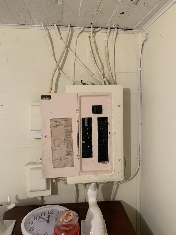

Current Situation!!!
But going to have the cabin completely rewired so trying to figure out how much juice we’ll need.
Awesome! That’s what we call in the trade a “rat’s nest”.
