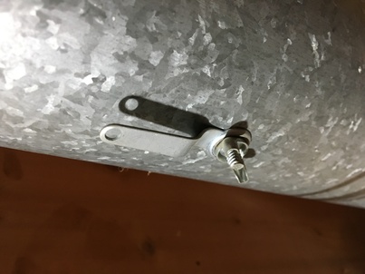

Look for something like this
or this
Somewhere on the duct leading to the under-heated room. The two shown are fully open. At right angles to the duct would be fully-closed.

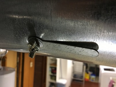

or this
