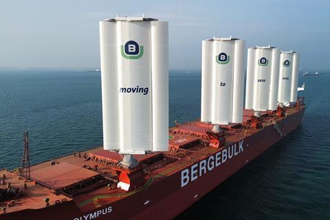

Its a series of rotating masts used to harness the Magnus Effect to help pull the ship forward. It is not a sail in the traditional sense.
These will only reduce engine output, they cannot be used in place of the ships engine.

Cheese n Rice, read the thread, there are no "sails" or Booms, rigging of anykind.
These are cylindrical rotors, the forward movement of the ship turns the rotors, the rotors in turn create power to run the ship.
I would say electric motors turn the rotors. The rotors don't create power - they create lift, but in the horizontal plane (forward thrust) using the Magnus effect (and Bernoulli's principle). Much depends on the wind direction relative to the ship and whether they turn clockwise or counter-clockwise. Winds coming from either the port or starboard beam are probably the best. In operation when the rotor is switched on and starts rotating in presence of wind, the change in the speed of airflow results in a pressure difference which creates a lift force that is perpendicular to the direction of wind flow. This provides the ship with an additional forward force which reduces the engine’s fuel consumption.

Looks like we're talking about all different things, apples, oranges, bananas.... There's different kinds of sails. They all harness wind propulsion in different ways.
BILLOWING SAILS: a traditional sail design
90 by kpkina, on Flickr
WING SAILS: airfoil-based sails rotate into position, but then stop at the optimal angle of attack (they don't continously rotate):
ROTOR SAILS: use electric motors to rotate continuously and utilize the Magnus effect for propulsion.

Most sail boats lean due to the force on the sail from the wind.
For oil & gas, not sure we want very large crude carrier and ultra large crude carrier class vessels leaning. That's 200,000 to 500,000 deadweight tonnes.
Then, I start thinking about the cargo ships with the conexes stacked higher than the hull height and I'm even more skeptical of those leaning. Looking at new Panamax class they're stacking conexes 10m high and the hull is only 6 m. Megamax-24 class vessels are stacking conexes 13m high and the hull height is 12m.
The risk of capsizing seems rather large. Environmental disaster for supertankers, and huge business disruption if a ship goes down with 24,000 conexes.
If it works, it works. I am not a naval engineer. I doubt a shipowner will unduly imperil a valuable vessel if these sails coupld be problematic.
And they are doing to save fuel costs. Reducing emmissions is a side benefit.
Picture of 229DAK
The thrust/force vector from these 'sails' is pointed forward and is controlled by the rotation speed of the rotors and the direction/speed of the wind relative to the ship. All computer-controlled w/input from wind sensors. If there is no sufficient forward thrust/force, then they are simply shut down. Additionally, there is not enough effective flat plate area of the rotors to cause any lean on these massive ships.
I don't believe we'll see these on container ships. The containers would block the rotors, which require secure mounting to the structure of the ship.
