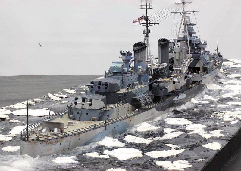

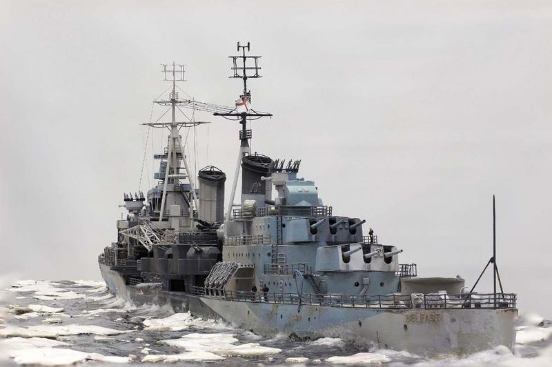

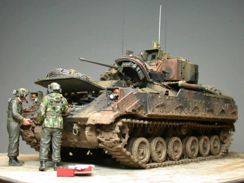

Check this out: Diorama & Model
It's awesome.
For instance:

This an awesome site. Here are few more dioramas:
Incredible talent by these guys.
