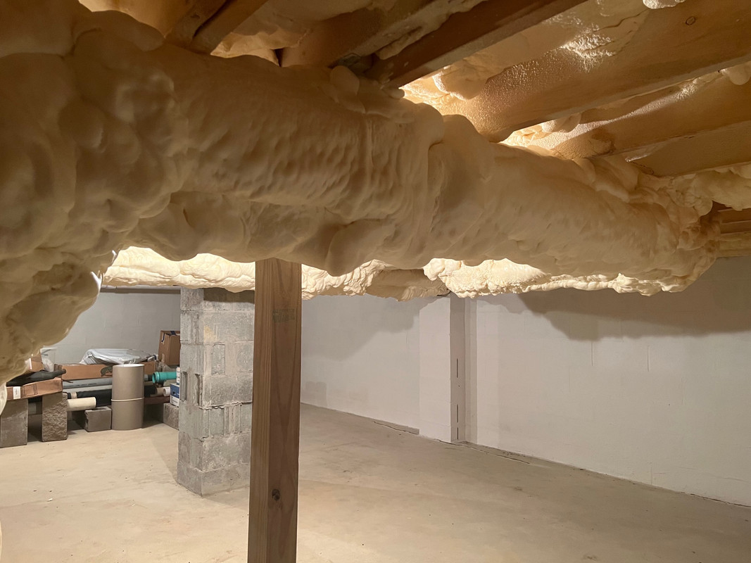

I had it done when building the house 23 years ago. We didn't cover the walls because I wanted to be able to keep an eye out for any moisture coming through or termite tubes but covered from the sill plate up, under the floor, and all the metal ductwork. It's nice having a floor that's not cold in winter.

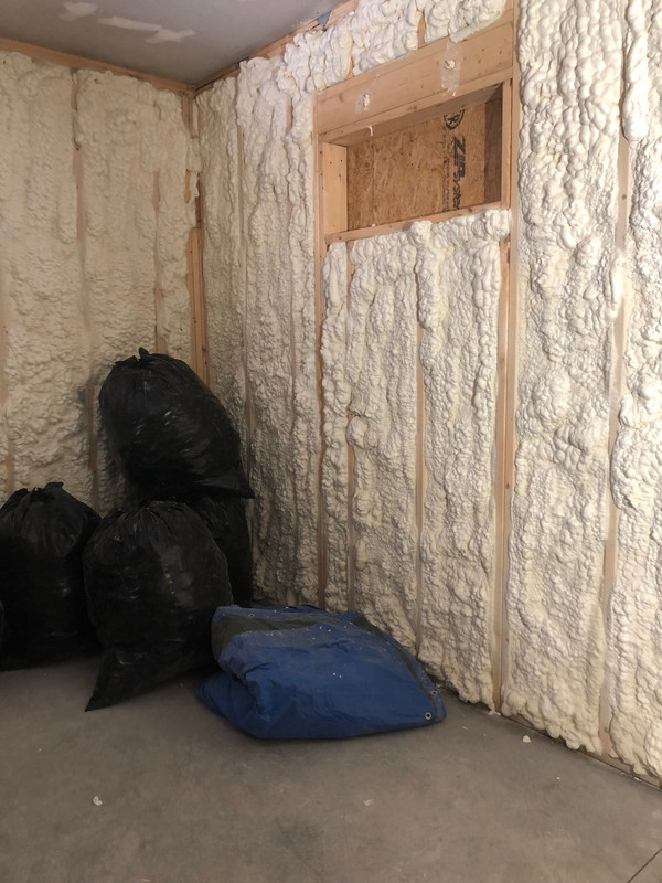

UK housing consists of a *lot* of old solid masonry structures with little to no insulation. In an effort to assist, the government offered incentives to add insulation and a lot of companies sprang up to insulate these old houses and many insulated (including spray foamed) stuff incorrectly. For instance covering the underside of attic roofs (unconditioned areas) that had old tile roofs that seeped water. It's cold and very damp much of the year and due to the high cost of energy they tend to keep the inside cool so a lot of moisture builds up looking to condensate on cold outside walls and attics. There are horror stories everywhere, including the US, of all types of insulation done incorrectly causing rot and mildew but that's the exception rather than the rule.
My personal experience having lived in many houses over the years, mostly old ones that I insulated when remodeling, but two brand new, is spray foam is simply more effective than batts of fiberglass or wool because it completely fills in and blocks air infiltration. Go to most any new construction right after it was insulated with traditional rolls of rock wool or fiberglass and inspect it closely. You'll find a lot of little gaps where cold will come in, ends that were cut short or crooked, creases and wrinkles, gaps behind receptacles not completely filled in, little misses around corners, windows and doors, etc.
I'll just say that after doing it both ways I'll never go back to rolled insulation.

Much quieter too when you foam the walls.

Thanks for info and picture!
