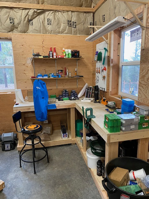

This is what I did for my reloading bench when I first built my shop.
I have another 20' long one of these on the other side of the shop as another work bench. Solid as can be.
