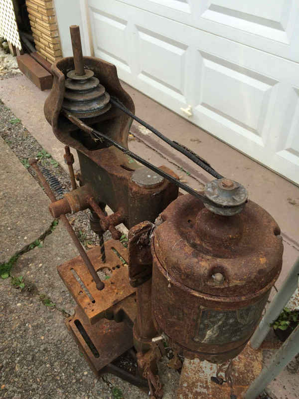

I've mentioned this before in other threads but back in the 1950's my dad had a leather shop. He got a 1938 era Wards Power-Kraft drill press that he used for many years. It moved into another business where it served until he passed. I grew up using this lathe.
In 2006 or so the building it was in was damaged in a hurricane and water dripped down and made the press damp which caused rust- here it is before-

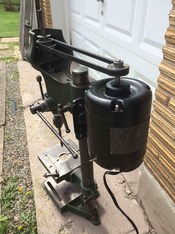

Here it is after-
Only thing I painted was the motor and I masked off the brass ID plate. The rest was originally raw metal and it cleaned up nicely. Those original painted areas were done pretty darned well.
In cleaning things like this- bronze wool and oil works well for the delicate. I replaced all of the original bearings and one bushing. I found one broken piece in the motor speed control that I had to make but it was straightforward. New cord. (Always add a ground if not originally equipped).
Biggest thing I learned about doing old electric motors is whatever you do- when you are cleaning/scraping/brushing dust/dirt/debris/rust from electric motors, dissembled or not...
DO NOT blow compressed air into the armature/coils internals. Instead- vacuum material away with a brush head shop vac as much as possible. The reason for this is that much of that rust/metal debris is conductive and if you blow it into the winding/armature it will cause problems. As far as value- if you like it and you get it at a workable price, use it and enjoy it.
