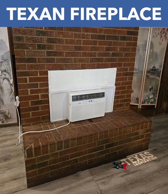

Dumb question: I was considering a split AC system (ducting through the external wall) to cool a particular room instead of using central AC (cooling the whole house when not needed).
This is in the funny pictures thread but perhaps it would in concept actually work (assuming the fireplace duct is open).
Is this really functional? Or is this dumb? If this actually would work, it would be easy for me to as DIY. The split AC would require a contractor and be more expensive.
I have no need for the fireplace otherwise.

I think condensate management would be an issue.
Many window units drip on the outside.

And heat exhaust. Without some sort of vent low on the fireplace to at least induce some airflow of hot air, it would operate way too hot. Even then, I doubt it would be enough.

Interesting, I would of thought the heat would go up the chimney, didn't realize a vent would be needed.

Hmmmm. Okay, so sounds like perhaps might be viable pursuant to condensate and airflow (perhaps a bathroom ceiling fan? But what about source for make-up air?).
But sounds like more ill-advised.
I guess the best way is still a (costly) split system.

There's no combustion going on . Why would you need make up air ? In theory this is just like exhausting air out of the window .

I think it could work but I think the output of cool air will be limited by the exhaust of warm air out the back. The constrictions of the fireplace flume and upward ducting would be a problem I think.

That was my point, maybe I didn't make it well enough. With a window unit, you have the whole of the great outdoors as exhaust. If mounted in a fireplace, you have just the chimney, with very limited airflow to get rid of the heat.

Yea, as a non-expert, I was thinking perhaps a bathroom fan (300CFM?) w/ some allowance for make up air (this is tricky) would help with active upward ducting (rather than passive).
If this could work simply, then it'd be a nice, easy, reversible method to cool the room. Otherwise, would consider the split ac through the wall.

Blower fan to blow the heat out of the chimney? Some chimneys have a fresh air vent, to prevent taking the air out of the room - any chance you have one of those? If not, can a hole be drilled in it, to let the water out?

And the bricks will absorb heat, but to a diminishing extent.
For reference read about how the Tube underground system in London has gotten hotter and hotter by the decade - not because of global warming - but because of the surrounding ground absorbing more and more of the heat from the trains operating, and being heat saturated and unable to fully dissipate the heat.
Yes it would be.
An AC unit needs to be able to exhaust hot air....chimney works for that as hot air raises...and needs to be able to take in air to be cooled and pushed into the room. The larger issue is routing the condensate that is removed from the hot air.
Mini-Splits solved this issue by having their condenser in the outside unit and routing the refrigerant to your room unit. The room unit circulates the air in the room, cooling it as it passes over the cooling coils...it is like the closed loop when you turn your car AC on the recirculate mode...as opposed to taking in outside air
Have you looked at portable AC units?
https://www.amazon.com/gp/prod..._title?ie=UTF8&psc=1
You do need access to a window to vent hot air
