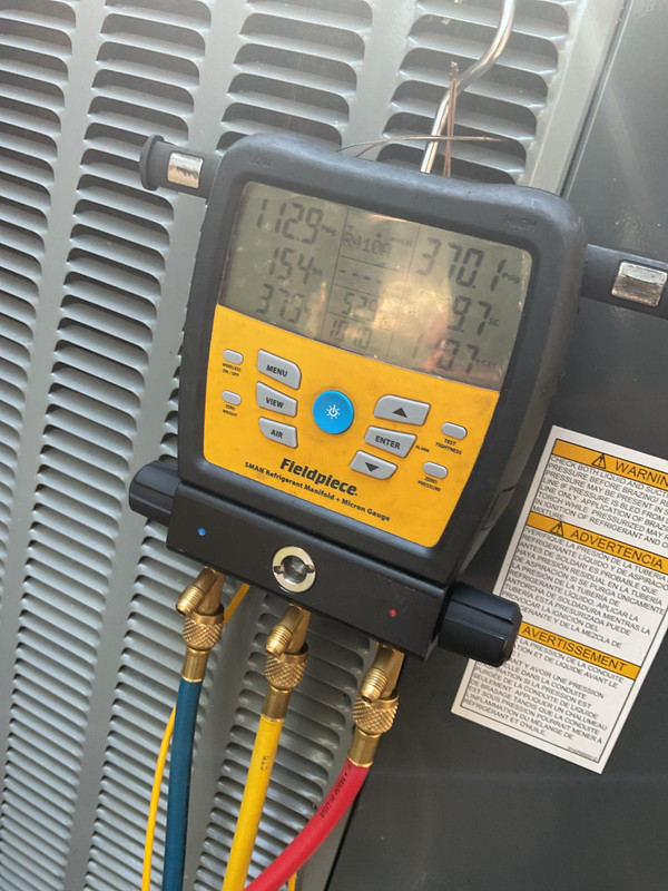

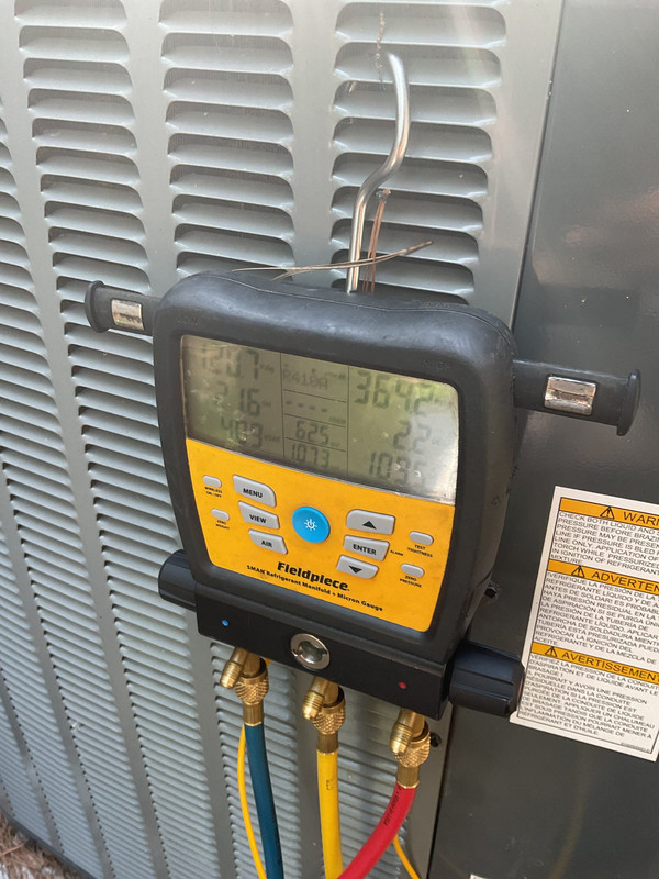

Below is the gauge readings before/after the recharge on Monday. Not sure if they'll post in order or not

First picture looks to be the after picture to me. Unfortunately you are past the point of free internet help, you need an in person visit from a pro. I hope your guy on Friday can fix it, else you will have to call in someone else.
