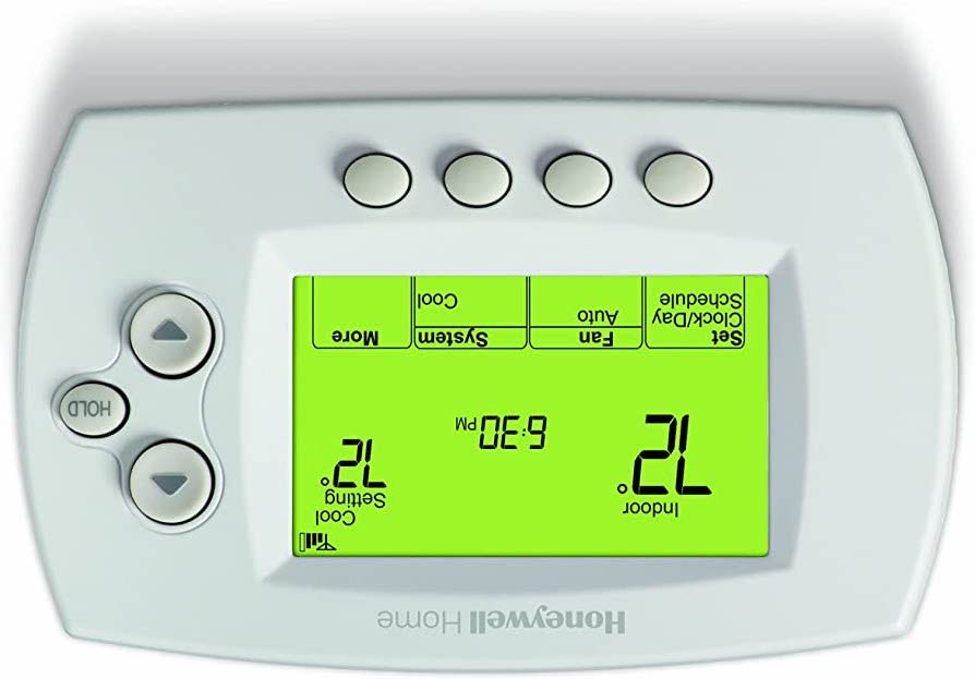

Originally posted by architect:
Obviously, you forgot to reverse the polarity of your battery connections.
Another possible cause:
