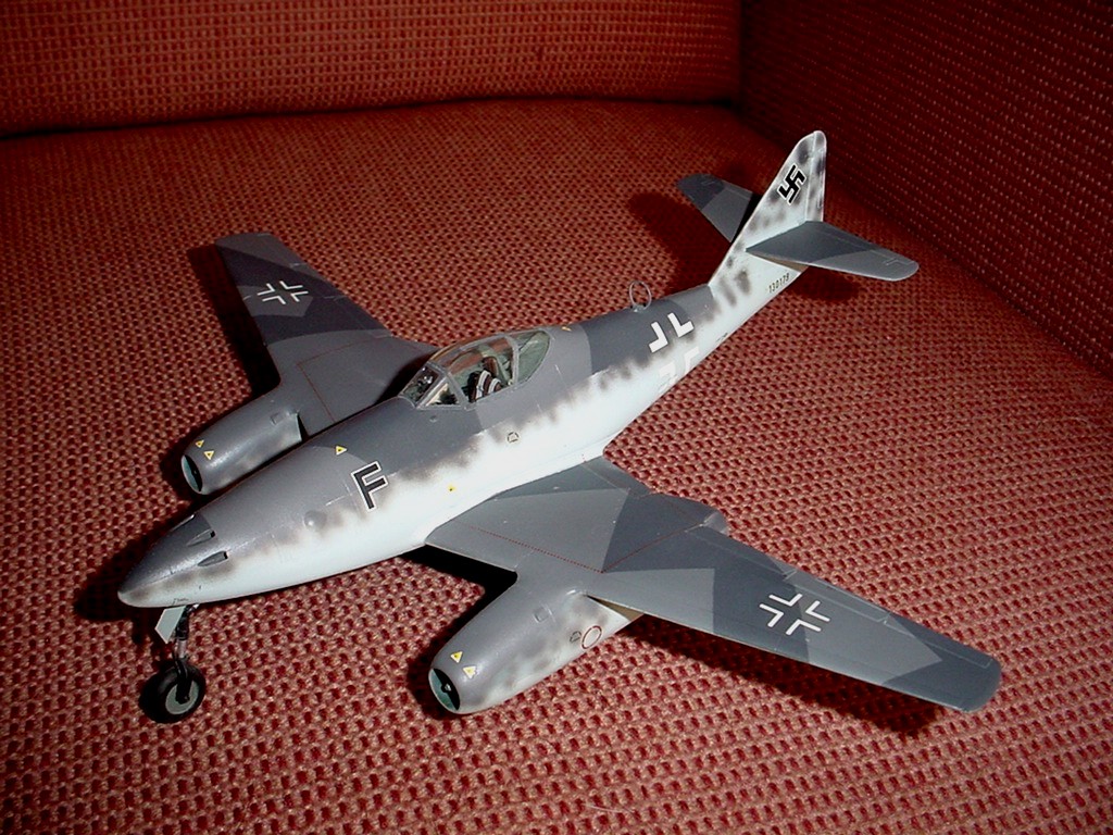

I wouldn't dismiss a single action airbrush outright. I did this 1/48 scale model using one.
I think it is a good way to start off airbrushing, then, assuming he wants to stick with it, he can move up to a double action unit.
