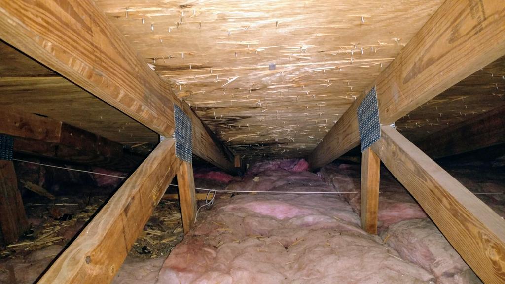

Leak Identification
I crawled my 6'2", 235 pound, 56 year old self through the attic for a half hour and finally found the source of the leak. Ultimately, it was a result of really lousy work done 14 years ago when the roof was replaced. The leak was in two truss bays, so the extent of the repair increased.

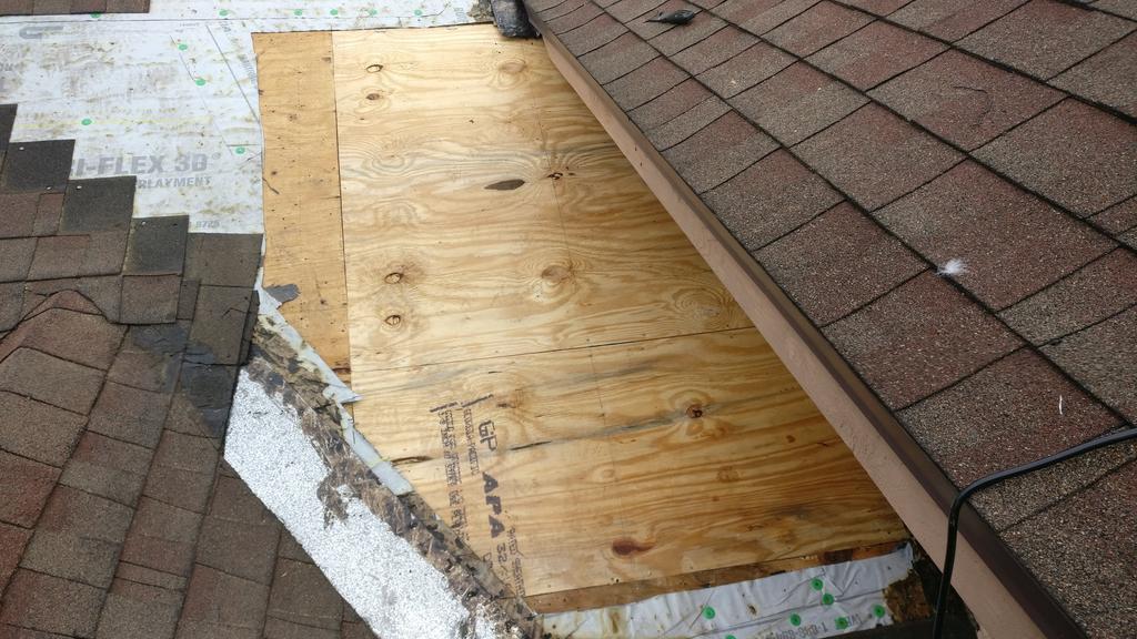

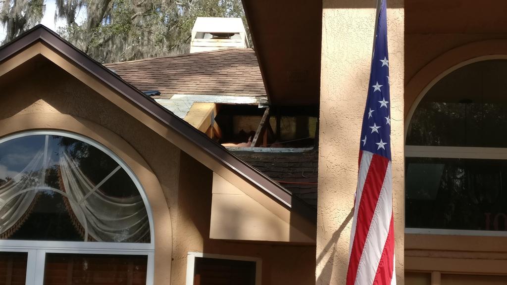

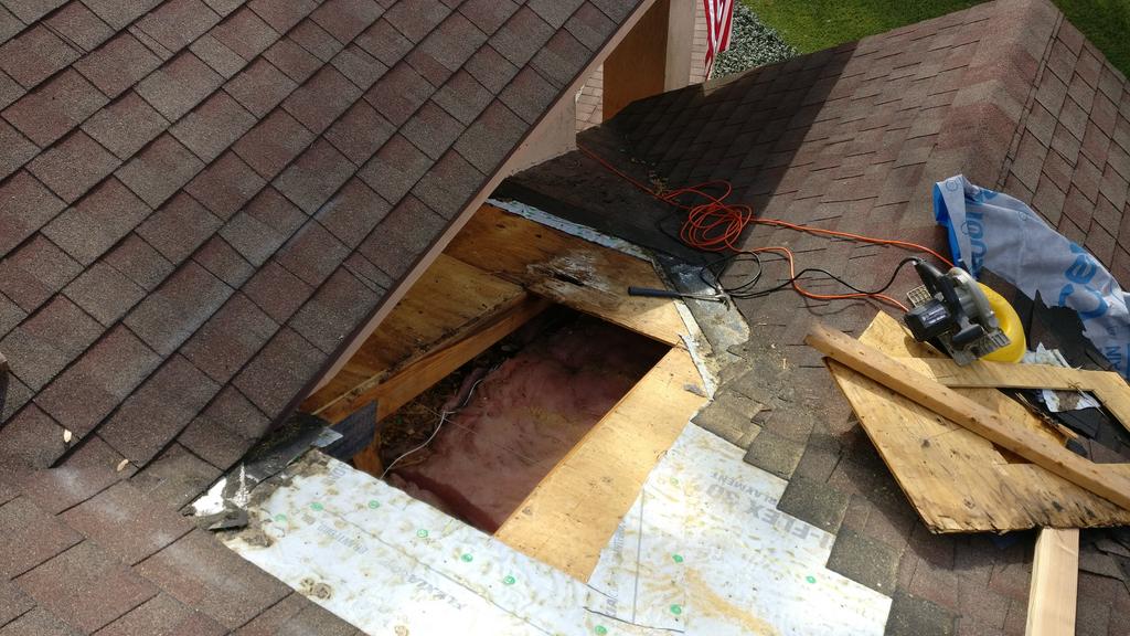

Tear Off and Repair
Long story short, the more I tore off, the more damage I found. What I thought was a small leak became quite a repair. Since one of the leaks I found was directly over a truss and had caused a bit of water damage to the top of it, I sistered the truss on both sides with a pair of eight foot 2x4's, and added blocking to nail my repair sheets to. Overkill? Yes. But that's the way I roll (and it cost me nothing given I had the 2x4 lumber in my workshop). I replaced every bit of wood that showed any discoloring or damage, and then used rolled peel and stick underlay to seal the entire area (and then some around it). Then all the seems against the vertical wall and valley were further sealed using a bucket of roof adhesive. Unfortunately I forgot to take some pics of the installed peel and stick.

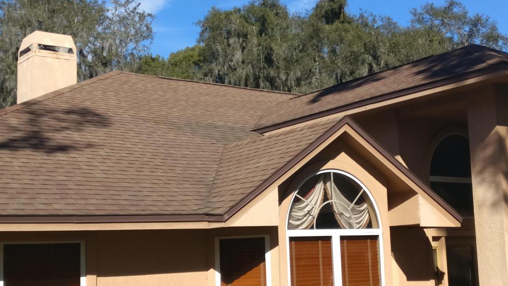

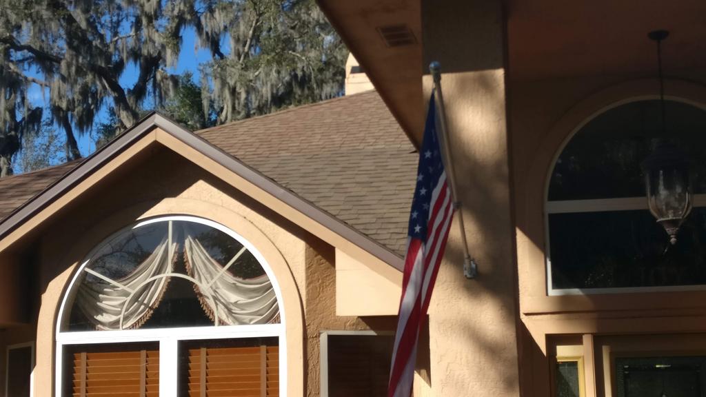

Bought two bundles of shingles and went to work. Unfortunately the shingles on the house are 14 years old and no longer available, so I was stuck with using the best color match I could find. I wish it matched better, but its not horrible, and given the amount of shade that's on the roof throughout the day, it doesn't stand out too badly.
Summary
'My' roof repair ended up costing me a few days of my time and ~$250. And I guarantee the estimate the roofers gave me would have gone up as they exposed the additional damage I found. All in all I likely saved $1,800 - $2,000+ doing it myself. We've had several days of heavy rain since the repair was completed, and I've not found any leakage anywhere in the attic.
