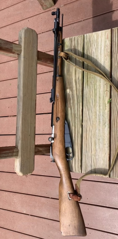

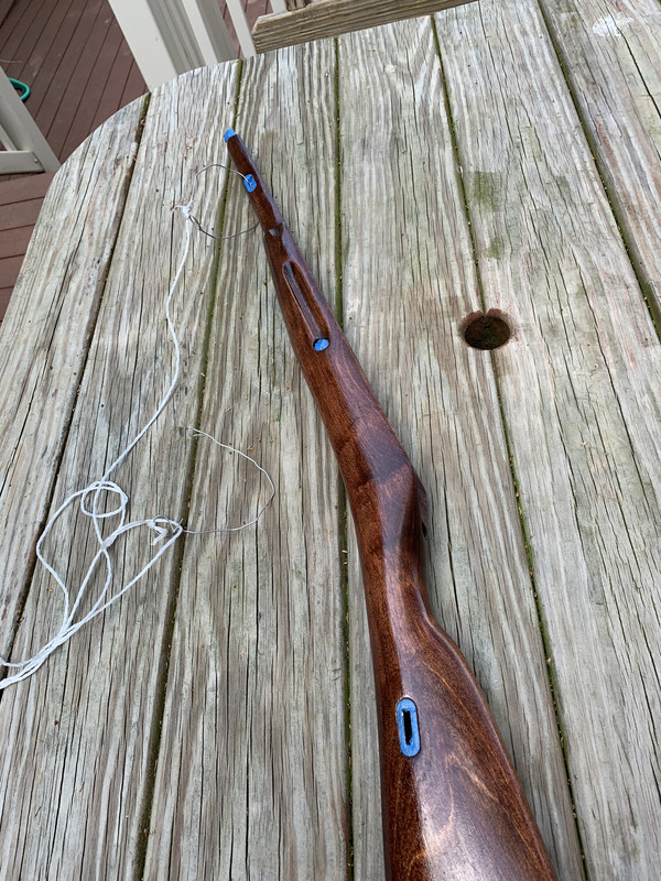

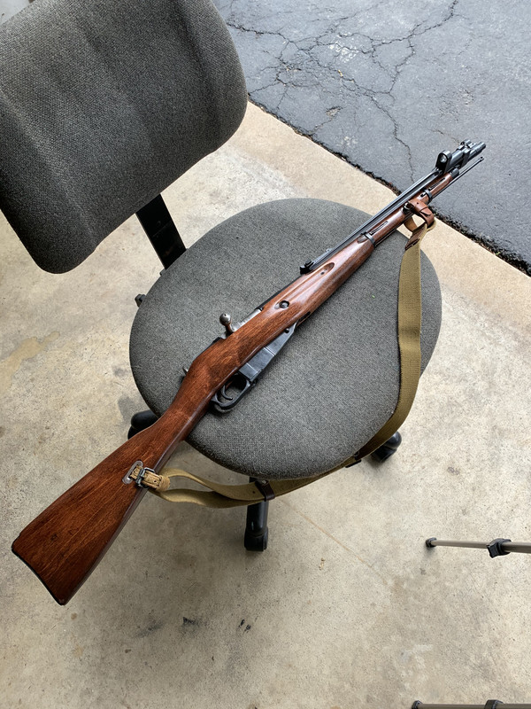

I fully understand that refinishing older guns generally devalues them. That said, refinishing and already refinished older gun shouldn’t raise too many eyebrows.
When I bought this M44 the original reddish hue was already replaced with a walnut looking stain job. It looked good and was done decently enough but I decided to redo it more for a project than anything else.
It was just a matter of removing the old finish, applying a few coats of Minwax number 225, red mahogany, and then topping it off with a few coats of tru oil. Patience is always key making sure everything is fully dry before taking the next step. I know it may appear too glossy for some but it is to my liking and if I change my mind some triple zero steel wool is already on hand.
Thanks for looking and as always, all comments good or bad are always appreciated, Brian

You did a really nice Job!
Picture of Kraquin
Looks nice

Very nicely done!!!

Looks Sharp! Cool

I have never liked Mosins but yours looks great. I think you did a great job. It just might be the best looking Mosin I’ve seen.
Picture of bripro
Thanks for looking and taking the time to comment. It was a fun project albeit one that tested patience. It was so tempting to just rush it when applying the coats but each process got at least 24 hours in between.
