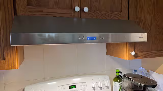

Picture of ridewv
I recently replaced my 22 year old GE vented hood. I wanted one with more air flow, quieter, and better lighting. I went with a Broan Glacier 30-inch, 450 CFM Blower, 5.5 Sones, Stainless Steel hood and it improves all 3. It's so quiet on the lowest speed I questioned if it was even moving enough air to open the flapper door but when I went out and looked the flapper was open and air was blowing out. One reason I went with this one is at 19.5" deep it projects out a couple inches farther over the range than most hoods but still not in the way at all. At speed 2 it moves out more smoke and steam than my old one did at max speed, while being *much* quieter. Max speed is rated at 450 cfm and I have only used it a few times simply because speeds 1&2 are all that's necessary most of the time. The LED lighting is nice too. It can vent up or out the back and was $400 shipped IIRC. https://www.broan-nutone.com/e...rangehoods/bcdj130ss
