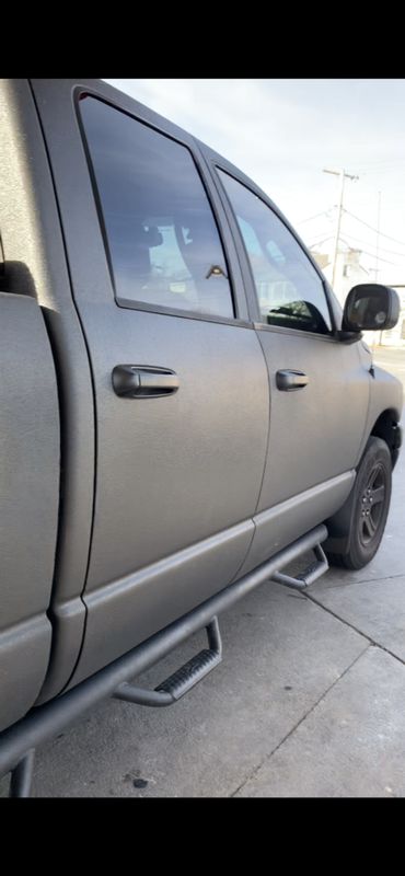

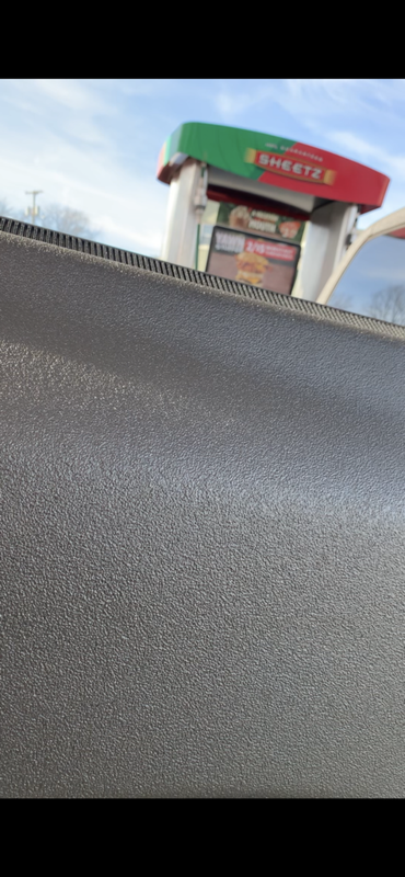

If washing and waxing or ceramic coating is too tedious, you could get the whole vehicle Rhino-lined/ Linex'd. Saw this Tundra at the station the other day. The whole job was $6,000 over all exposed body and frame metal. I'd think it would be very desirable to somebody wanting the ultimate in protection from the elements. Comes in several color options Big Grin
Posts: 16640 | Location: Martinsburg WV | Registered: April 02, 2011Reply With QuoteReport This Post
