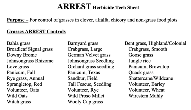

Arrest Max is the grass herbicide that people use who intentionally plant clover food plots for hunting. Make sure it's what you want as it will kill nearly all of the following grasses:

tatortodd
Nope, Scotts Halts crabgrass pre-emergent should not affect clover. It only works on crabgrass and a select few other grassy weeds, like foxtail and poa.
(And from personal experience, it certainly doesn't prevent clover from growing in my yard.)
I use Halts to prevent crabgrass before it appears, then apply 2,4-D to kill broadleaf weeds like clover after they appear.
2,4-D is kind of the opposite of Halts. It's a post-emergent herbicide that doesn't affect grassy weeds (or normal grasses), just broadleaf weeds.
Scott's label leaves a lot to be desired so I just checked domyown.com to find another product with the same active ingredient (pendimethalin). It said safe for Crimson clover but would kill hop clover (white clover family).
