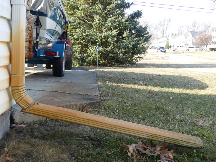

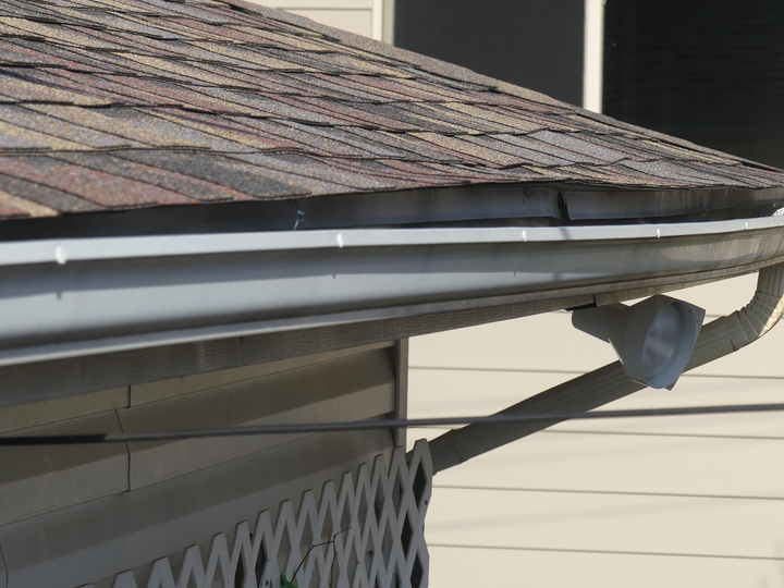

Several years ago I noticed this downspout, the end of which originally slotted nicely over the end of the elbow at the bottom, wasn't any more.
"Garage is sinking?" I asked myself. But it didn't appear to be, because the foundation was still high & dry. "Hmmm..."

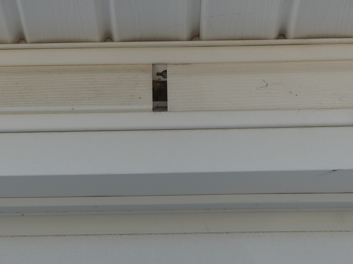

Next thing I noticed was a gap forming in the vinyl siding above the garage door.

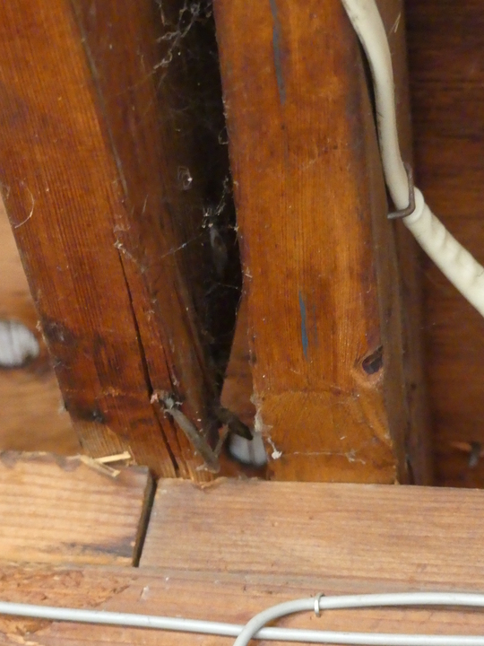

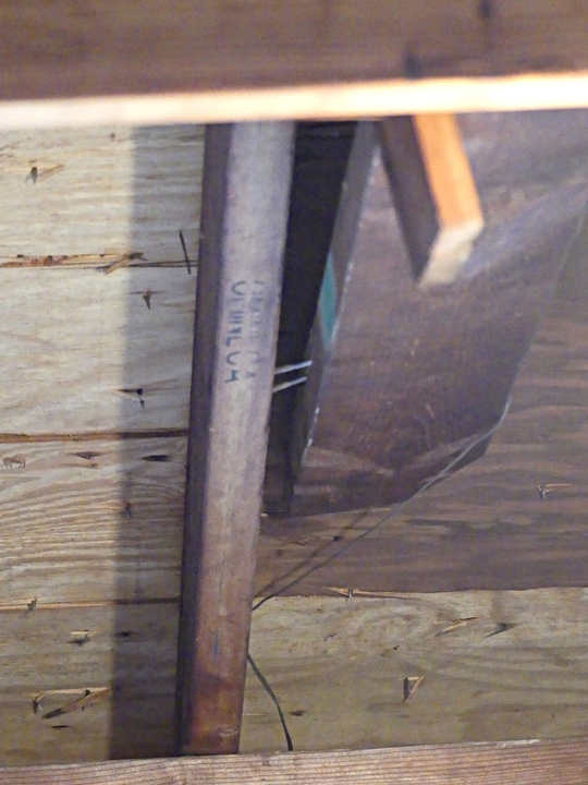

Look inside and see:
That's the end of one of the rafters that runs from the front of the garage to the back. It's barely on the sill, any more.

Vinyl expands and contracts significantly, and it typically is overlapped an inch or more. That gap means they butt it, and it settled out. Or it's something else which I'll get to.

So, my caveat being that an in person look would be best, but here is what I see. With a garage door that is 18' open span, and a low slope roof that looks like 2x4 rafters, I have to ask, how is the snow load each year on this thing? Hopefully everything is at least 2x6.
The "joist" going across the garage, should not be the only triangular support for the roof rafter, there should be a midspan and ridge support. This is to resist the down force of the roof being turned into outward force against the wall top plate. What you should see is the rafter nailed directly to that joist, as well as toed to the top plate. Looks like they didn't connect the joists and rafters...

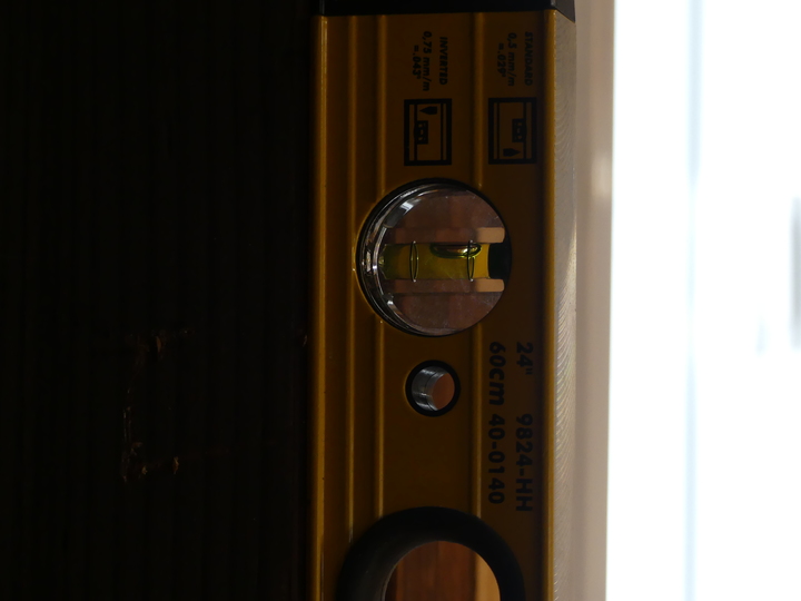

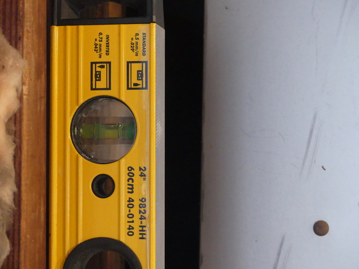

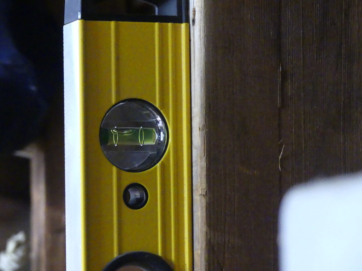

I would put a level on the walls, and if they are leaning out at the top, away from the roof, well, bingo. That would mean you're a few good snow storms away from listening to your garage roof crush the contents, some wintery night.
That gap has been steadily growing for a number of years, now. I've been remiss in addressing it.
Well... they kinda sorta did, but not in the way you describe. Furthermore, with what you're saying, I think probably I made matters worse by putting a pair of 4x8' sheets of plywood across those joists and using the space for storage.

... and those gutters look like that typically due to icing.
There's never any icing to speak of in or on that particular gutter.

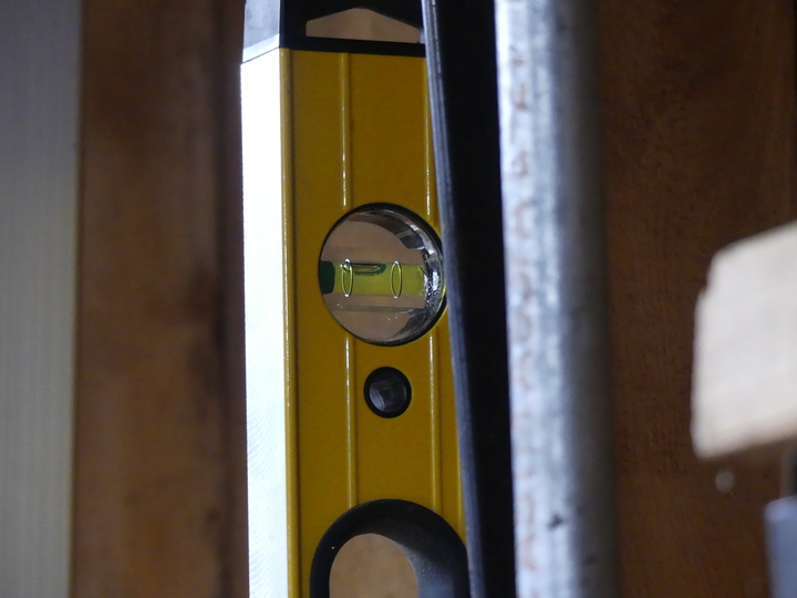

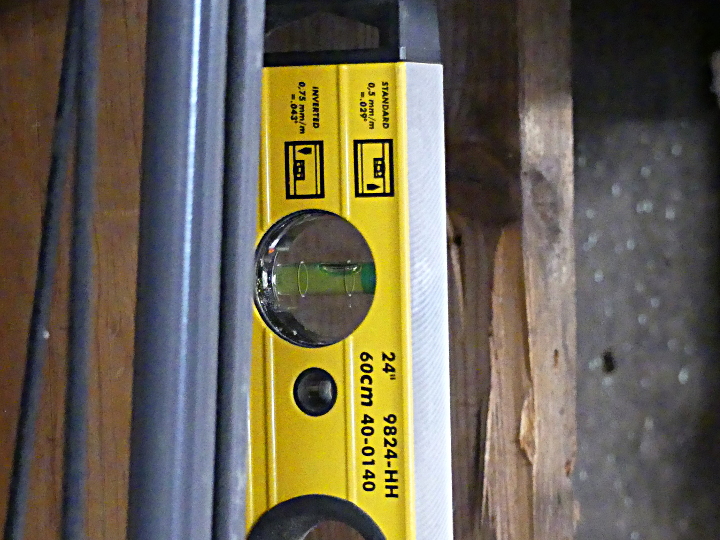

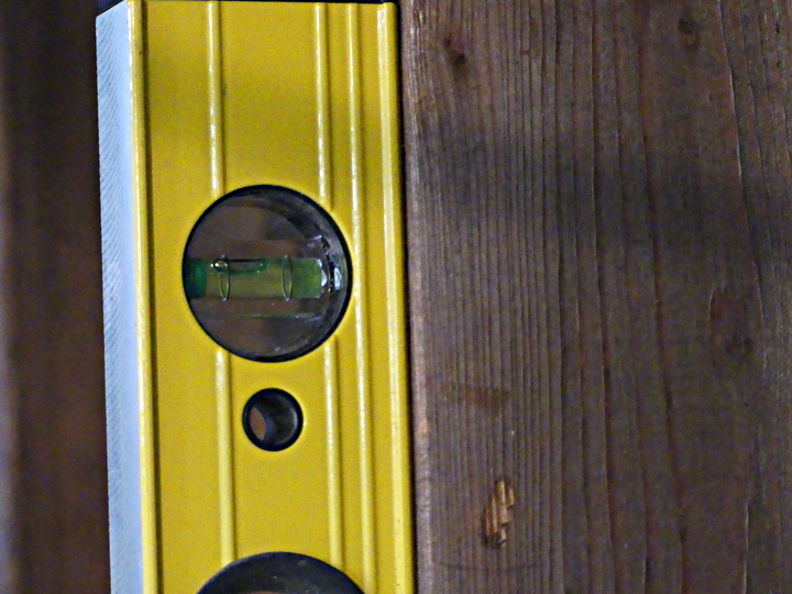

First three photos are the back wall. Next three are the side wall away from the house (the perspective isn't the same on them all, but they're all leaning out):

Originally posted by arcwelder76:
Because of your location I'm thinking snow load, and that the garage is unheated, and maybe if you do rake the roof it doesn't happen a lot, or the previous owner didn't.
I used to rake the roof, but, after the re-shingling a few years ago, where they installed a Tyvec-type "felt" and snow and ice shield 3' back from the walls, it seemed no longer necessary. Plus I never got much in the way of ice dams on the garage, anyway--which was the main reason I used to rake the roof.
I could be wrong, but check those walls for plumb.
Done and they're not.
Thanks for your expert insights, Arc!
Originally posted by RespectTheAmish:
If you don’t see large cracks on the concrete floor, or other signs of differential settlement.
There are no cracks at all. Not even little ones.
(2) SPF 2x12s are way undersized for a 18’ span, to a point that makes me wonder about the gravity load path. Is your garage opening located an end wall, or sidewalk of your home?
Sidewall, maybe?
It's an attached garage, one wall, adjacent to the garage door opening, of which is one wall of the house.

Picture of TigerDore
I think you need a second and maybe third opinion.
I don't even have the first opinion, yet.
When I look at your pictures, I am thinking foundation. Under-spec'ed joists aren't going to create those kinds of problems.
Foundation isn't going to cause sags in the middle, either, and there is definitely sagging going on. That was evident even 15-20 years ago, when the gutters were installed, and they couldn't make the front gutter work quite right because of the sag in the middle. So I knew, even back then, that someday I'd have to address that.
I forgot about the snow load up there, as arc mentioned. It makes sense now. Good luck with the repair.

Got the first ball-park estimate for fixing the garage: $8,000 to $9,000.
Arc called it: Improper construction is causing the roof to push the walls out. If it's not corrected, and relatively soon, the whole thing will eventually come crashing down.
The builder concurred with my guess that it was originally a 1-1/2 car garage improperly expanded to be a two+ car garage.
I'm going to have to empty the entire garage for them to get it done. That, in itself, will be a non-trivial undertaking.
He gave me a couple suggestions on things to do to slow further degradation until the repair can start.
And, yeah: It's so bad that it would almost be worth knocking it down and building a new one. But we just had $8,000+ worth of new roofing put on a couple of summers ago and all the electrical and communications service entrances are on the garage's back wall.

Update
Consulted with one of my next door neighbours, who, while not a professional construction type, is quite experienced in building things.
"Nonsense," was his reaction. His recommendation: Take the pressure off the walls a bit with a jack under the center beam of the roof, use a pair of come-alongs to bring the walls back in, re-anchor/-attach the joists that came loose, add the missing joists, done.
He also pointed out the header is not sagging. Put a level on it in several places. Walked outside and looked. Showed us how the appearance of it sagging is an optical illusion.
