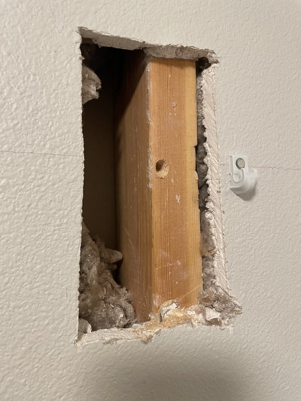

I was hanging a shelf in the laundry room and needed to drill 5 holes in the wall. Four holes were done and the fifth one I hit (what I thought) was a wood stud.
In hindsight I was having to push harder than I should have had to but I kept pushing .. all of a sudden I heard a crack / pop and the big toe on my right foot started burning like hell. I yelled out “ow, ow, owwww” really loud and wife yelled to me “what’s wrong”. Felt like my toe was on fire for a few seconds.
.. I quickly realized what had happened and couldn’t believe it.
I was pretty dazed and confused for a bit.
Wife called 911 to be safe, although I was talking and seeming fine, generally. My heart rate was pegged and I was trying to catch my breath for a good ten minutes.
Paramedics hooked me up to heart machine and said everything looked okay .. aside from heart rate, which ultimately came down.
Five hours later now I still feel kind of dazed and really tired.
I haven’t opened up the wall so I don’t know it it was 110v I hit or the 220v from the dryer. I don’t know if I was drilling through one of those metal plates they put on so you can’t drill into wires .. or what. I’m pretty sure it was just 110v … I don’t know, I’ve never been jolted like that. 220v would have ended me I would think. House is a brand new build, only a month old.
Anyone else have a similar story? I’m just waiting for my superpowers now.
UPDATE: I pulled back the drywall today only to realize that I was drilling into wood … WTF?!?! My dad is in town today and, after looking everything over, we are scratching our heads. There isn’t any wire on either side. And my drill hole is only about an inch deep. We are wondering if the actual 18V Makita drill I was using somehow shocked me?
Can anyone explain this?!

Just how the hell deep were you drilling these holes?
Assuming 2x4 stud construction with drywall over it, any wire you hit should be over 1-1/2 inches from the surface of the wall.
You need to find out what circuit that was and de-energize it until you can open that wall up and find out what you did. That is now an imminent fire hazard.

You probably hit a 120V Romex cable that was stapled to a stud. 240V would’ve killed you on the spot I’d think?
Did you find a tripped breaker for that circuit?

Not going to happen in this case and 240 volts isn't the monster you think. It's not an instant death sentence.
You must think about this situation for a minute.
Case #1
Drilling into wall with a bit... bit hits a 120 volt hot wire and becomes energized.
Case #2
Drilling into wall with a bit... bit hits 240 volt line (two 120 volt hot wires, dead short) and trips the breaker. Unless, it only hits one wire, then you're back to case #1, only coming into contact with 120 volts.
The only way for him to have been electrocuted by anything more than 120 volts, is if he had been able to touch more than one wire at any given time. As in hanging onto a wire in each hand. Or one in hand and another touching his body.
This isn't going to happen when you hit a wire with a drill bit.
There is a slight chance that with crossed wiring, the voltage can go up, but a very slim chance. Most of the time the breaker is going to trip and not let that situation play out.

Breaker did NOT trip. Forgot to mention that.

I'd make sure that breaker is off and tapped over until you get the repair made to that circuit. It would be bad news if there's any arcing going on within the damaged insulation.

I suspect that's exactly what you did. I suggest hiring an electrician to fix it. Like others have mentioned, turn that breaker off. You've have damaged the wire. Trying to use it at close it's undamaged rated capacity will cause the wire to heat up at that point which is a hole in a wood stud. Fire hazzard.
I am not an electrician, so I'm guessing repairing it will be adding a box to the stud on the left or right of the one you drilled into and pulling the wires coming from the panel into that box. A box can't be put on the stud you drilled into because the wires will be too short. A new wire will be run from the box to whatever outlet the now damaged wire was feeding. Connections will then be made inside the box between the wire from the panel and the new wire. My guess anyway.
