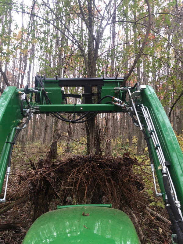

The grapple is perhaps the single most useful attachment I have. (Admittedly I have too many) I added the third function valve myself. WR Long brand if I recall. Took a couple hours to install. No complaints except the piston in the valve can get stuck if not used for prolonged period of time. I took it out, put it in drill and ran some emery paper over it and it hasn't given me trouble since.
Be careful with these little machines. Although quite capable, learn what they can and can't do. And be very careful operating on grades, they can tip over faster than you think.
Additionally, check in the manual which fasteners require retorquing. I didn't and broke some loader bracket bolts. No permanent damage, but if the load were higher when that happened the results could have been worse. Wheels are another component that requires periodic checks.
Replacement hydraulic hoses can be made up by a local shop for much less than the dealer. Sometimes while you wait and get you back to work sooner.
If you trailer it, it's recommended you back it onto trailer. Often times these machines hood and latch mechanisms are not designed to withstand winds at highway speeds.
As jsjac mentioned, orangetractortalks.com, greentractortalk and tractorbynet are excellent sources on info.
Just an aside, orange and green compact tractors manufactured in Georgia, they are not imports.
