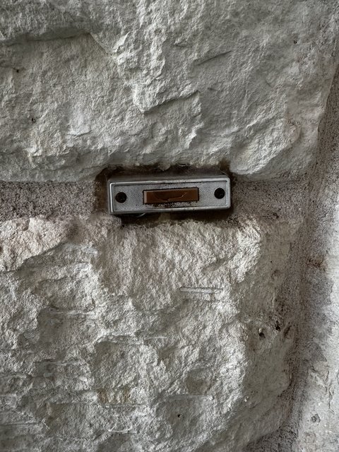

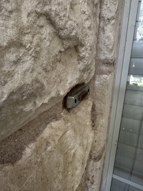

I would like to mount a doorbell video camera, but my doorbell is in the mortar between very uneven limestone brick rock. I am sure someone in here has a good suggestion on how to do it.
I bought a Wyze v2 Doorbell Camera but now I don’t know how I can mount it so I figured I would ask here before I return it. The camera has to be powered by the wiring of the existing doorbell.
Here are some pictures of the current doorbell and the rock above it sticks out much more than the rock below it. Thanks in advance for any suggestions.

I'd say it doesn't really matter what you use the camera will be facing the wrong way. I think you can only get 40° from the angle mount you'd probably need somewhere near 70° to point it in the right direction.

Maybe a small 90 degree angle bracket from the box store. Throw it in a vice and make it around a 45 degree angle. It looks like one leg would fit where the existing button is and the other leg could have a piece of 1x screwed to it the size of the new doorbell. That gives you wood to mount to and a better angle.

Remove old button,fix a piece of wood to the mortar joint using some tapcons (countersink wood so the screw heads are sub-flush). Use a piece of wood maybe a 1/4" smaller in dimension than the angle bracket/ camera base you plan to use. It will sit wonky but you can set the angle against the uneaven limestone with some 2 part epoxy putty... maybe 3 points of balled up putty.
Wait until it hardens and tighten the screws once more. Use type N mortar to fill all the gaps around the limestone wall and bracket/camera base leaving a finished appearance.
Probably difficult to envision but it is similar to the way we would mount pumps. It wouldn't permanently damage the existing stonework if you ever remove the camera altogether.
