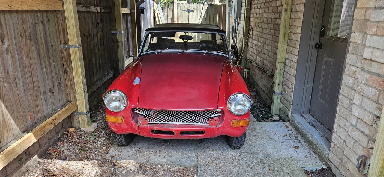

Roof repair looks tidy, hopefully will get you through that eventual SRV Texas Flood that always happens when you go out for a run.
Front suspension and brake work looks good, the upper control arm rubber bushes look a bit worn and cracked, are they on the list since you have it all apart, presume there is a lower ball joint that's on a future list or do they look good, since it's been sitting a bit, rubber parts tend to get hard and crack.
Like the Greys you could go in trend with the flat non metallic grey that Toyota et al are using. My choice would be White, car looks a bit bigger in white, reflects the heat, and, doesn't show body imperfections as bad as the darker colors do, so, you don't have to be as super anal about body work

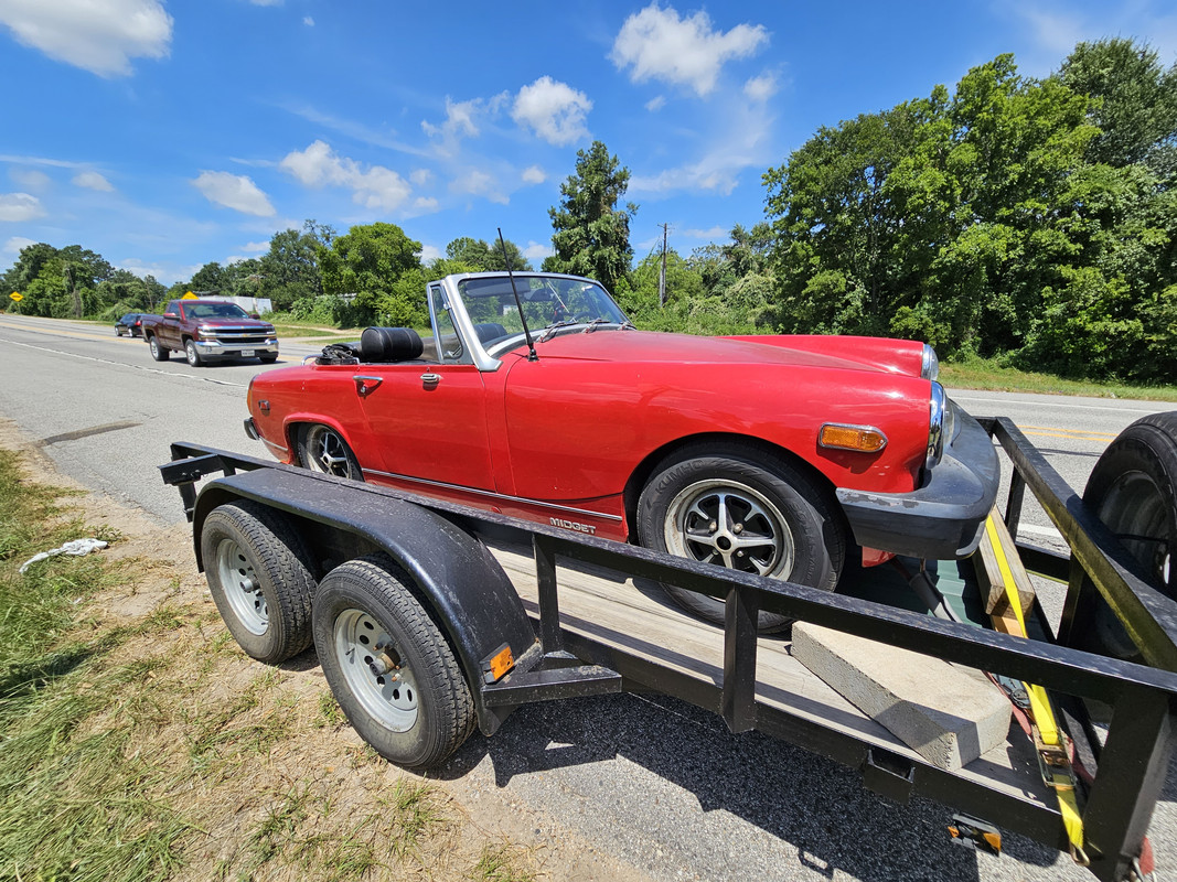

About 30 miles in, stopped at a light & tenp shot up, started bucking when we got a green. Pulled over & was dropping coolant
Going to trailer her the rest of the way. Thinking it's the fan clutch. Good opportunity to go electric.
And, back on the trailer, hopefully for the last time
She was running great otherwise.

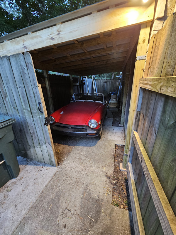

And, after an extremely long day, she's home in a partially enclosed 'garage'

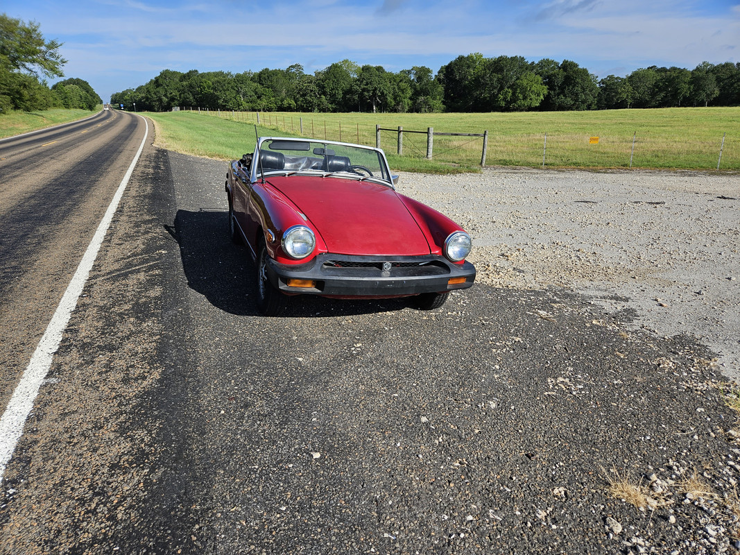

Took the Midget out for a brief spin today, route with no stops other than 2 stop signs in my neighborhood.
Held around 180-190 at a steady 40-50mph cruise.
Temp climbed in the brief stop to back into the driveway.
Fan had no resistance when hot.
Parts are already on the way for a clutchless conversion. Then on to the next thing that needs fixin'.
8yr old came with, her first ride in a convertible, she had a blast, despite the mid 90s heat.

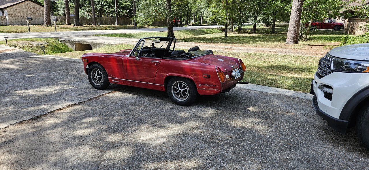

New water pump & clutchless fan installed, fresh coolant.
Also got the rubber bumpers [shockingly heavy] and grille removed.
Temps were holding in the 175-180 range in stop/go driving, big improvement.
My wife took her first drive in it & after a stop [engine off] the starter didn't disengage [dash interference with the key held it in the start position but it wasn't engaging the flywheel after the engine started].
Maybe a half mile like that & it wouldn't restart, nothing from the starter. Had to bump start it to get it home. Was running fine, but now the starter does nothing from the key.
Going to let it fully cool & see if it is maybe just overheated.

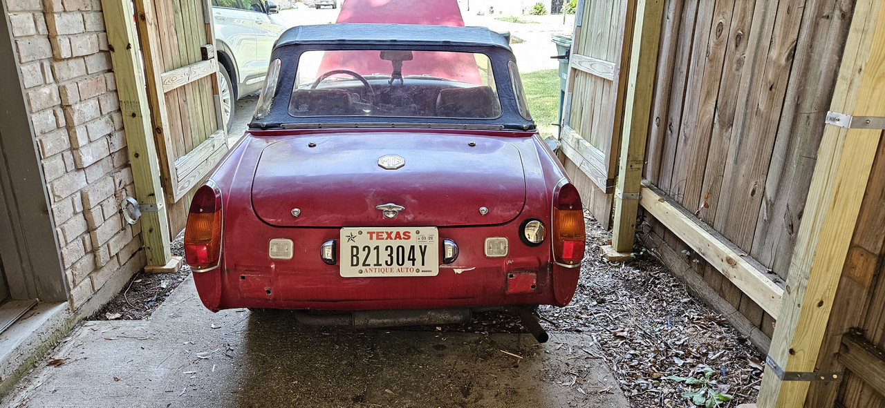

Rubber bumper delete nearly complete, just need to source an earlier year grille
Was able to cobble together a solution to retain the original blinkers & mount them in the holes left behind in the fenders.
