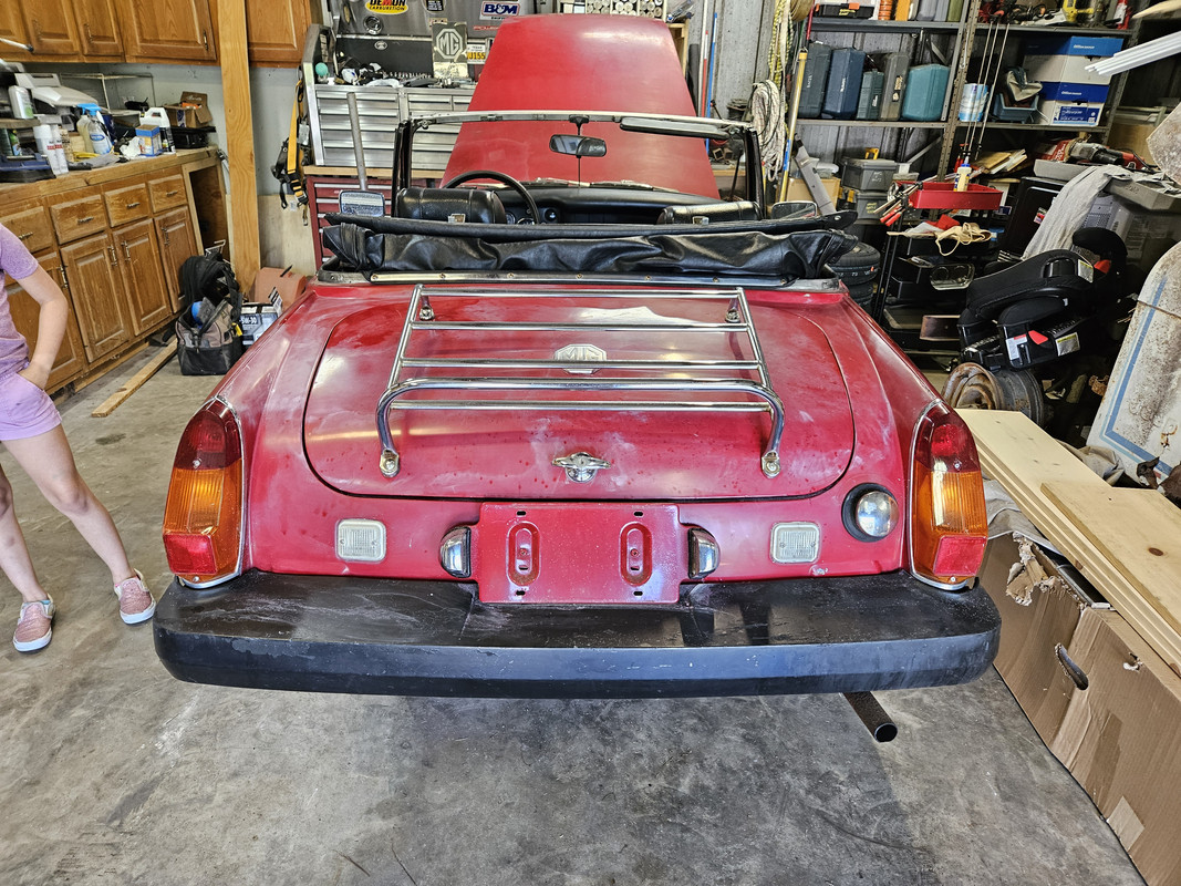

April 04, 2023, 11:49 AM
P250UA5

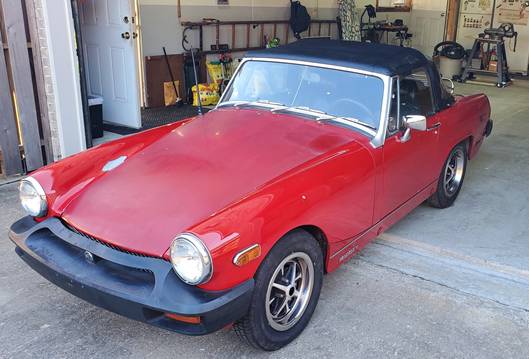

The saga continues.
Was bummed to let the Lotus go, but it would've just rotted away at our house, since we don't have a garage.
Posted this, and subsequently went to look at the Midget.
My wife has wanted one for years, so that was a bonus as well.
https://sigforum.com/eve/forum...935/m/7210052994/p/1

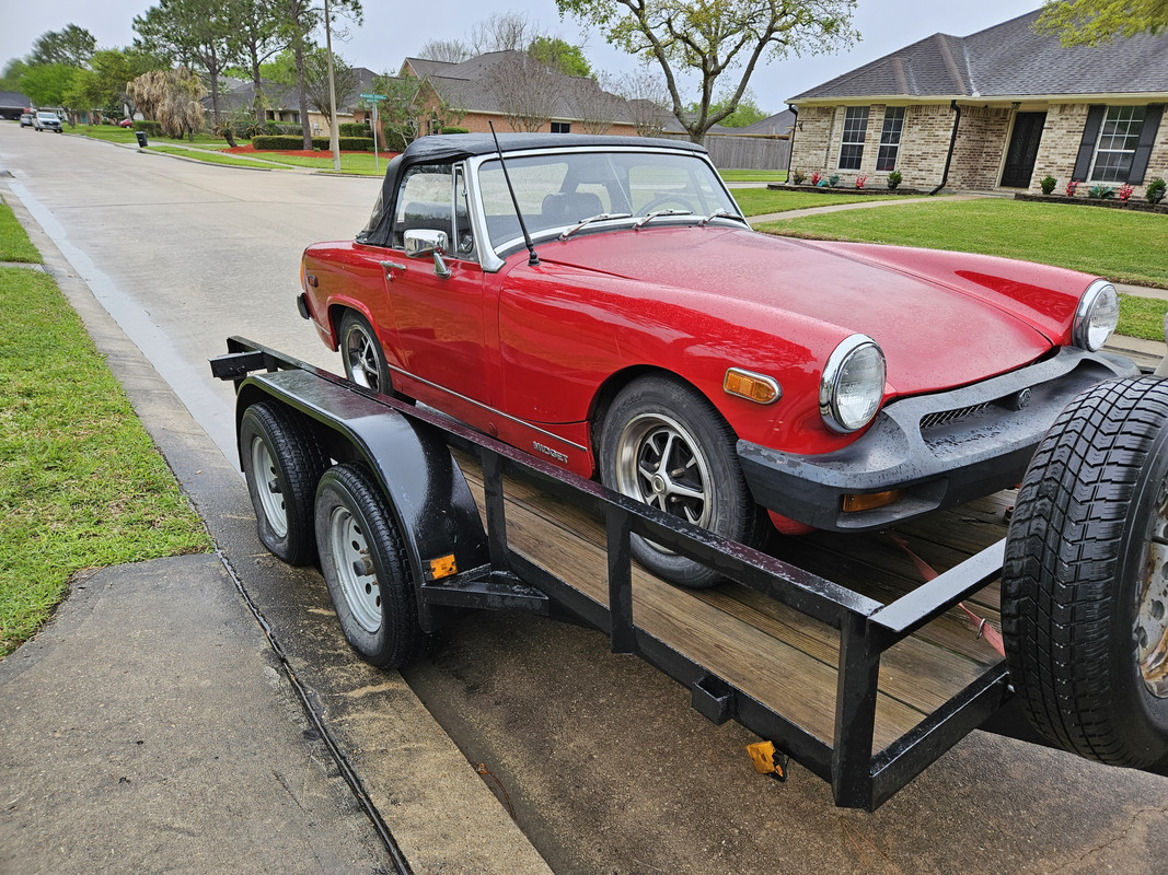

Gave it pretty thorough lookover, as good as we could without a lift. Brought my dad along, as he knows older cars a lot better than I do.
Needs some work, but the price was appealing & we made a deal.
It was on 10-12 year old tires, so we agreed it was not ideal to try to make the 65 mile drive across Houston & risk ending up on a rollback or injured.
Went back the following weekend & trailered it up to my dad's shop.
Spent a day going over it with a flashlight & Haynes manual, just getting to know what/where everything is & what's non-original.
Needs a dent fixed on the LR quarter & has a small tear in the top to repair, and a fairly poor paint job, but no significant rust, just a few spots of surface rust.
Car has all of the emissions gear removed, no cat, and has a Weber 32/36 carb on a Canon IM, and some unbranded 4-2-1 header.
Ordered some parts for it, parts are hilariously affordable & surprisingly available.
Tires, likewise, are very cheap. 5x 155-13 tires were <$400 delivered.
Front left caliper drags, tie rod ends were shot, gas cap out of round. Should be getting up there to replace those this weekend along with engine/trans/diff fluids. E-choke on the Weber is being replaced as well, when we picked it up to trailer it home, we had a lot of trouble getting it started & the choke was wide open. The thermal spring wasn't connected to the choke pivot.
We put it back together properly and it fired up on the first turn, but the choke wasn't opening, so a new thermal spring was ordered to see if that alleviates the issue. Worst case, could convert to manual choke.
Bodge job on the exhaust. IIRC from 2 weeks ago, the header is a 2in and the exhaust is a hair bigger than 1.5in. Rather than done properly, one of the prior owners just plugged the gap with a slug of weld. That'll get cut off & a matching 2in exhaust run to the rear from the header.
Rear axle limit straps, rear wheel cylinders, clutch & brake MCs are all new. Fuse box replaced as well.
Thrust washers seem to be in good shape, from the visible checks I've found on the MG forum.

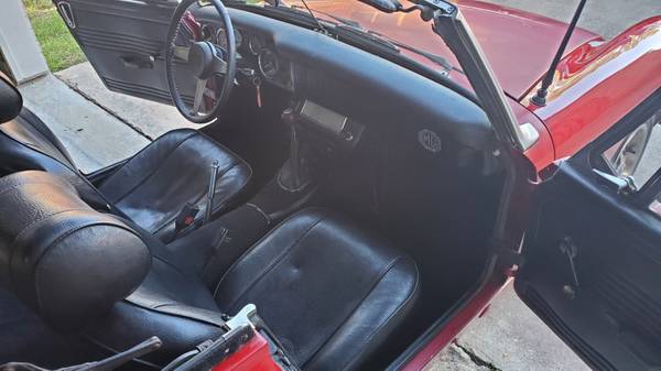

Everything, electrically, but the reverse lights works. Radio turns on, but just static, could be that it's in a metal bldg with poor reception. Plan down the road is to replace it with one of the vintage audio units with Bluetooth.

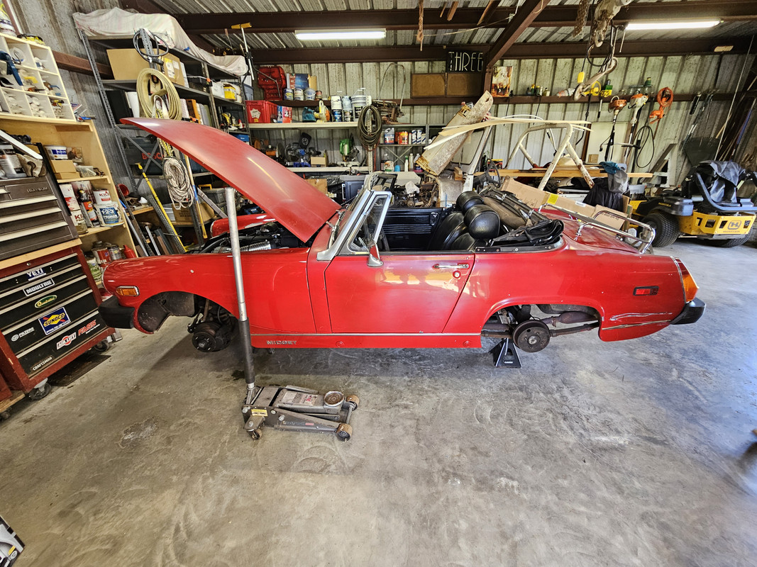

A few shots from some shop time 2 weekends ago
Rubber bumpers gotta go
Tiny pedal box area, but not too bad as long as you're wearing relatively narrow shoes
Still undecided on paint color, but have plenty of time to figure that out.
April 04, 2023, 12:09 PM
trapper189
I’m looking at the brakes and they are small. The rear drum caught my eye first. It’s a third the size of the parking brake on my truck. And then front rotor! That’s one way to solve wheel clearance issues, isn’t it?
That’s so cool. Cool
April 04, 2023, 12:42 PM
HRK
Is that dryer ducting for the intake,
I've seen where people remove the clutch pedal, then heat and bend it to move it out some for better clearance...
Nice project, quite a bit better than the old one...
April 04, 2023, 12:49 PM
Pyker
Excellent for 'heel&toe' gear changes. Rubber bumpers are the devil, chrome FTW. Color? Only choice is BRG!
April 04, 2023, 12:58 PM
P250UA5
Yes, metal dryer ducting.
Seems a common replacement, also seen ribbed outdoor drain pipe.
Excited to get her roadworthy, hopefully take it for a short spin after doing some work on it this weekend.

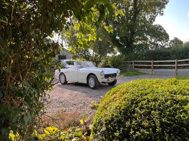

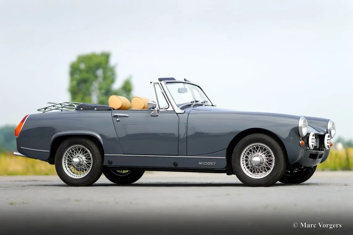

My wife found a 'Mini Cobra' midget in Dallas in dark gray that she loves.
I've found a couple in a lighter gray that I like.
The Lotus was going to be orange, but I haven't found any photos of a Midget in orange that I liked.
Top choices right now are gray or dark blue.
These 2 are my favorites so far
Any this one is my wife's favorite

I LOVE that gray. DO IT!
April 08, 2023, 10:09 PM
P250UA5
The bottom gray one is a Ford 302 swapped, and significantly reinforced chassis, Midgit Eek

Got a fair bit done on the old girl Saturday, but not enough to get her on the road.
Spent the first hour or two stitching the tear in the top & put a couple layers of barge cement over the top, still need to put a layer on the inside. Not very pretty, but if it holds & keeps the weather out, I'll be happy with it for now.
Installed new tie rod ends. Had to do it twice, since I didn't realize they're shipped with a cover over the boot.
New front calipers, made a mess & drained a fair bit of brake fluid, and had to relieve one of the ribs in the LF hub, as it was interfering with the caliper & stopping rotation. Just a light hit with the grinder & she spins free.
New e-choke thermal spring on the Weber. Opens & closes well, but think I may need a new coil, seems like it's getting weak spark. My adviser[Dad] thinks it could also be old fuel in the tank. Luckily it only has about 1/8 tank left.
Looked on Moss & see the 1500 coil there, but not the ballast.
Changed the oil & filter, drain plug was installed by the Hulk on its last oil change. Limited space to get enough torque to break it loose. No leaks after the oil was topped back up.
Went to do the diff, but didn't have the right size square bit for the plugs. 3/8" driver too small 1/2" too big.
Next trip I'll fill/bleed the brakes, fluid change on the trans & diff, and put another coat of barge on the top. Probably hit the underside with some superclean & tidy it up, help see of there are any current leaks to address, or if it's all residual buildup from X years of use.
Should be able to get her out for a spin after that.
