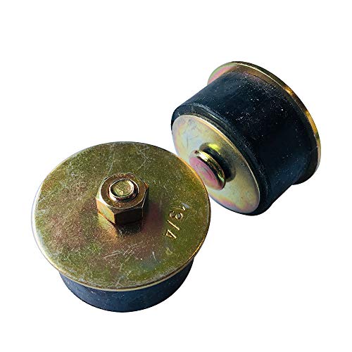

I know many years ago there were freeze plugs made that were brass with an expandable rubber ring. I used one and it worked well. Allowed you to remove the old one and insert this one and turn a pre-threaded bolt and nut to expand the rubber gasket into the opening. Could be a short time fix if they are still available for sale and use like the one in the link below.
https://www.autozone.com/exter...KvD_BwE&gclsrc=aw.ds

Core plugs were one of my most dreaded jobs, and I had a lift to put the cars on. I think the center one is behind the engine mount, too, so you have to jack up and support the engine while you're working. They are easy to pop out, but driving them back in is another matter. There are core plug driver tools available so you don't mangle the plug, but you still have to have room to swing the hammer.
The temptation will be great to use a rubber plug.
These are slipped into the hole and have a bolt running through the center to compress the rubber on the back side of the block wall. The SBC's block walls may be thin enough that the rubber will expand and seal, but there is great risk of them popping out. An inch-and-a-half hole in the block will instantly spew all the coolant out. Use steel or brass ones.
I'd recommend the garage, if you've got a trustworthy one.
