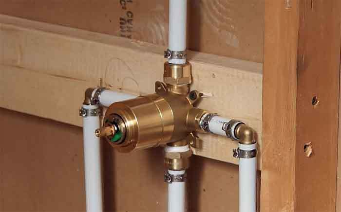

The valve body is usually screwed or nailed into a backer board or cross pieces between two studs. It all depends on who was working that day.
This pic may not be your model, but almost all shower mixers/balancers are like this pic and mounted the same. Depending on the plumber or weird codes the connections could be PEX, copper or steel depending on age.
