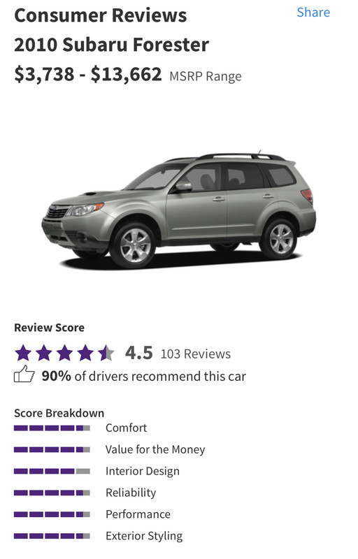

I’m looking at buying a 2010 Subaru Forester in fantastic condition so that’s not an issue but I’ve never owned a Subaru so I thought I’d ask here.
The Forum helped me dodge a Bullet on a Volvo a couple months ago so I figured I’d see what the opinion is on this model.
It’s a 2.5L non-turbo with 80k miles.

The auto review on line say to “expect 300k if all scheduled maintenance is observed “.
