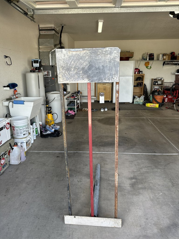

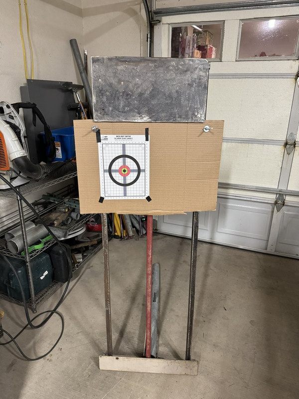

So I have some extra time on my hands, I decided tomorrow would be a good day for some range time. There are plenty of places to shoot around here, I just need something to hold my targets.
This was built entirely from metal in my scrap pile, along with the shooting plate.
I went into the garage and fired up the welder and cutoff wheel. A couple pieces of angle iron welded together added a couple pieces of rebar to hold the uprights. Cut the uprights to fit, and made a top connector out of the same tubing and some smaller diameter square that fits inside.
The arduous task of cutting whatever kind of steel this is that I have. 5.56 green tip doesn’t make marks in it at 25 yards. I don’t know if it’s AR500 or just hardened steel, maybe an up armored hummer hatch? Either way, it’s heavy AF, and it took four cutoff wheels to get through it. The plate is 9x18 and 3/8 thick. It started life as 26x18. I just have an extra piece in the garage that’s really heavy.
I added a couple bolts and wing nuts to secure some cardboard. I ended up adding a piece of pipe to the back as the plate is so heavy it would topple the stand. I need to find a 45 lb. weight plate at a yard sale, and modify it to hold the weight and ditch the pipe. The upside is that it disassembles in a few seconds and assembles in less than a minute. It all fits in the back of the RAV4.
I need to paint the plate white in the morning, so I can see my hits from afar.
I like the steel so I can hear if I’m hitting it when I put it out at long distances. It’s also at the right height for closer handgun shooting.
Best part is that it kept me and my mind busy for a couple hours. Now I can’t wait to break it in!

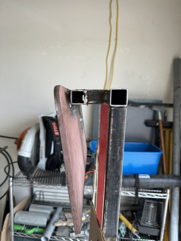

Is the top plate angled down? Or loose?
If it is solid and perpendicular to the incoming bullet you can get a richochet back at you.
Posts: 1186 | Location: New Jersey | Registered: August 16, 2009Reply With QuoteReport This Post
Alea iacta est
Picture of Beancooker
Slightly loose with about a 5° downward angle. I may need to increase the downward angle.

How far back away from the target will you be? It may good to consider lowering the steel plate so that you're not shooting upward to hit it? Hard to tell from the pic but it looks about head height (6'?).
Also, maybe consider some ground support forward of the frame so that it doesn't tip over toward you.
Posts: 15191 | Location: In the gilded cage | Registered: December 09, 2007Reply With QuoteReport This Post
Alea iacta est
Height is about 5’8”.
I added a spacer so the plate is tipped at an angle and it has some movement now.
I don’t want to add more support arms. I just need a 45 lb weightlifting plate. That’ll eliminate the post on the rear and make it more compact and easy to transport.
