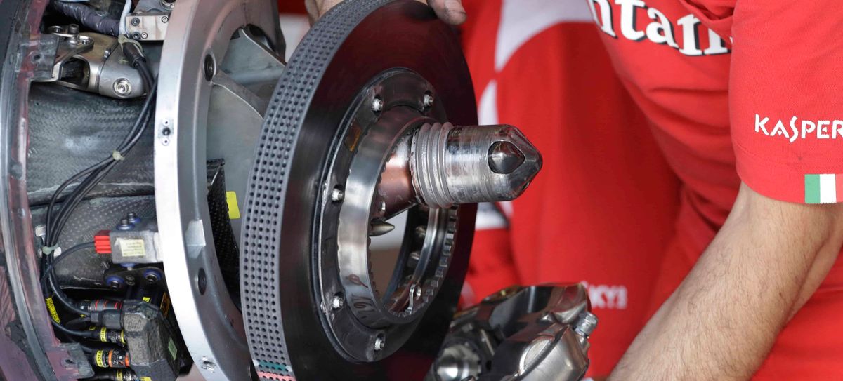

Close but not quite right. You will not find drilled rotors any any race car. Period. Most if not all race cars that are raced on road courses or endurance races have slotted rotors to aid in dissipating the gasses that “can” build up under very heavy (I.e. threshold) braking.
If I understand the OP he is asking about what to use on his trucks that will also be towing etc. We have used Cryoed Rotors for our trucks and also my Porsche race car as they will last longer than regular rotors.
The other major player is of course, the pads. Depending on how much initial “bite” you want in your brake application this will vary but which pad might be best suited for you is another discussion in its own right…

Case in point, F1 cars use solid faced rotors & they're pulling from 215 down to sub-100mph speeds
