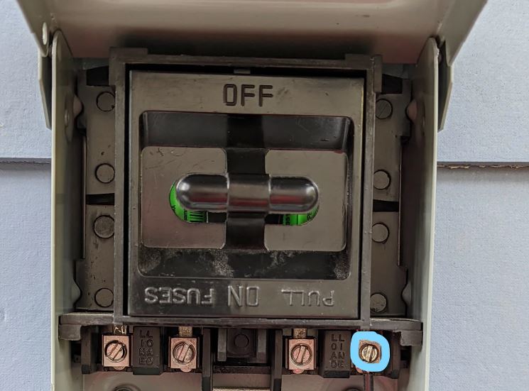

The Disconnect is in the OFF position and it looks like the wiring isnt complete (i only see one wire landed)
It is most likely off for a reason. Leave it OFF, turn the breaker back off.
The AC guy might assume that the breaker is still off and not check for voltage before finishing whatever he needs to do and get shocked in the process.
Also, there should be a plastic piece that covers the terminations so you can't reach in and touch 240V. Just another indication that the work has not been completed.
Leave it OFF, Turn the breaker OFF
