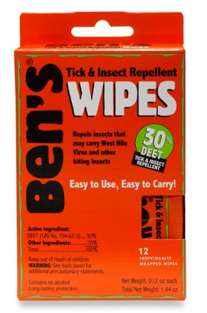

A friend of mine is an engineer on the Union Pacific railroad and is issued bug wipes that work wonders on discolored or cloudy headlights.
When he first told me about this, I scoffed at him.
First of all it seems to good to be true; just a wipedown with the bug wipe and you're good for about six months.
I've used the 3M abrasive kits and they require time and a little elbow grease so I wasn't too receptive to his idea.
Four years ago, I used it on a car with badly disclored headlights and did it twice after that. Till I got rid of the car, the headlights looked good.
I've used it on several vehicles since then and it does work.
The wipes in question are a brand that I had never heard of before but I guess they sell them at REI.
https://www.rei.com/product/75...t-deet-package-of-12
