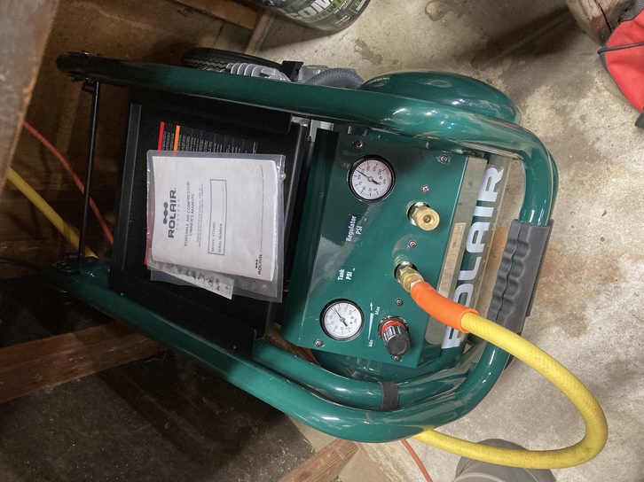

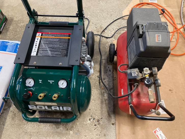

Upgrade time!
In it's new home:
The new compressor can supply up to 6.5 CFM at 90 PSI, rated for continuous duty cycle. Now I can drive air chisels and die grinders Smile
With the drain valve conveniently located right up front, it being a ball valve, and the compressor filling it's 5.3 gal. tank so fast (a minute and twenty seconds): It'll get turned off and drained after every use.

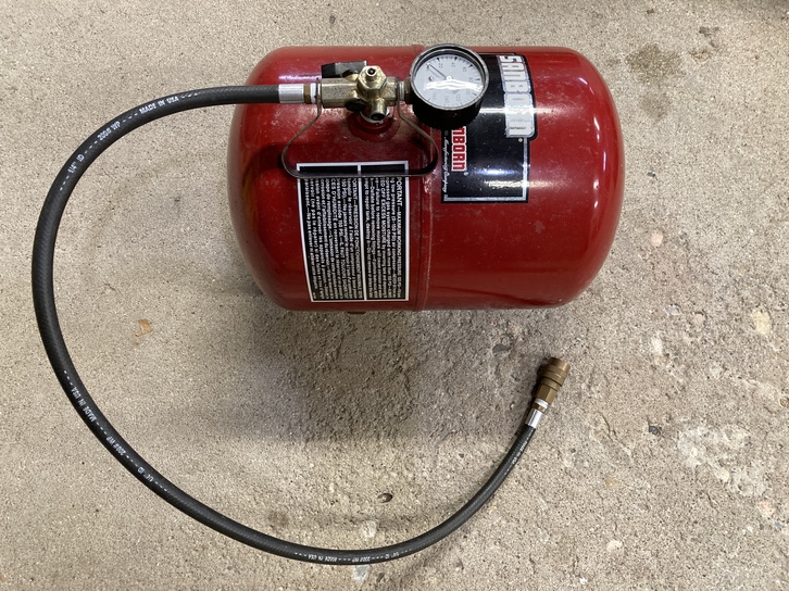

But now I had a new problem. This thing can do up to 135 PSI. My old 5 gal. portable air tank
is listed for a max of 125 PSI. Would have to be careful with that. Then I got to thinking...
I'd upgraded that portable tank once, already. Thinking it could drive my smaller air tools longer, as a portable tank, if I put a regulator on it, I'd done this:
Wasn't very effective.

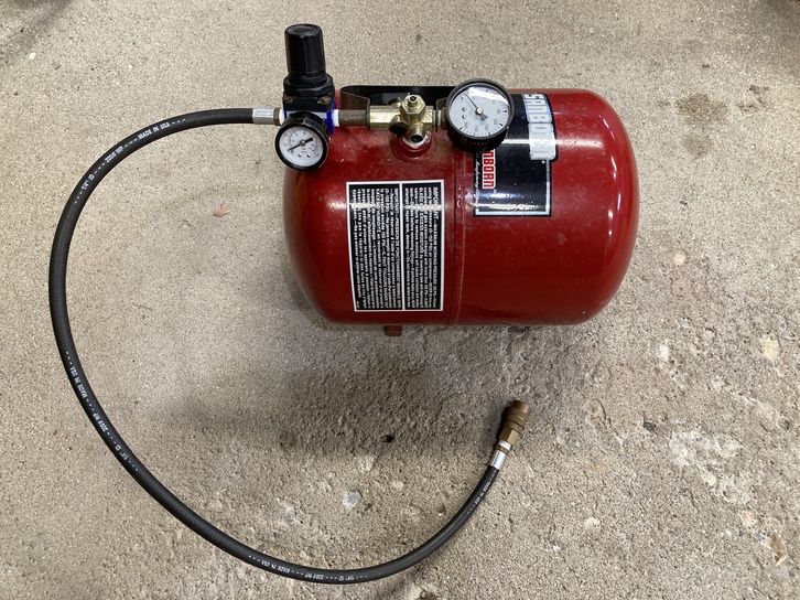

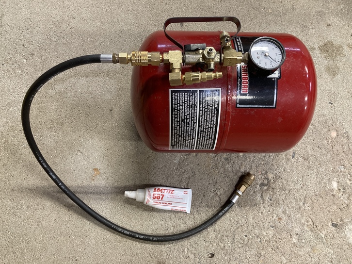

Hmmm... ok: Add a fill inlet with a check valve, replace the short little hose with a regular fitting, and add an over-pressure release valve to it:
The manifold had to be removed from the tank to get all that on it. I honestly wondered if I'd get away with doing nine fittings, all in one go, with none of them leaking. Darned if I didn't! Props to Loctite's 567 Thread Sealant, because I'm sure I'd never have gotten away with it with tape.
Now it can serve as portable air, for extra capacity (up to about 115 PSI [that's when the "125 PSI" over-pressure valve really releases, I found out]) to reduce compressor cycling, and as a reservoir to improve performance at the end of long air lines.

It was between that, California Air Tools, and Ingersoll Rand. The CAT is "made in America," but from mostly CCP-made components. IR doesn't say where their compressors are made. I wanted American-made. Plus this one fit where the old one was. The garage is kinda full Razz
The funny thing is: This smaller compressor is actually rated at higher CFM at 90 PSI than the other two were, even though they were larger.

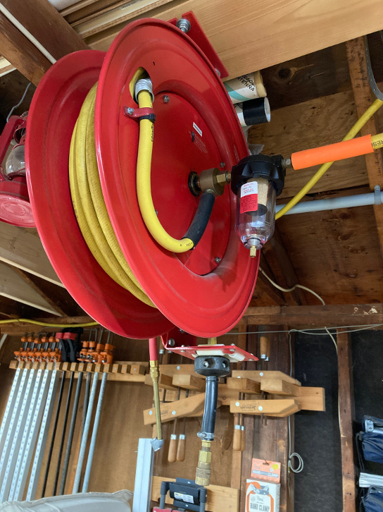

Nice. I just had an occasion yesterday to use my pneumatic die grinder and air hammer with a punch to drive a pin out of something.
I no longer own a portable compressor since I've upgraded to the IR 80 gallon / 16cfm @ 90 psi shop compressor.
I like the hose reel along with the filter and dryer, I've currently only got a hook from which the hose is coiled.
That hose reel was a Christmas gift from my wife years and years ago. (I've already replaced the original hose once, just from age.)
She got it for me after watching me wrestle with un-coiling hose, doing something, and having to coil it all back up, repeatedly.
It's a Beautiful Thing Smile
I do need to replace the coil spring on the simple ratcheting mechanism with a stiffer one, though. When it gets cold the ratchet lever wants to stick such that the reel won't retract w/o me sticking a screw driver in there and poking it out of the way.

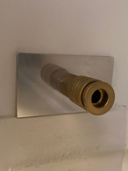

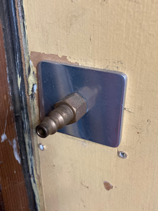

Here's another handy component of my air system. In the garage:
Just the other side of that wall, in an unobtrusive corner of the stair landing between kitchen and garage:
Allows me to use the compressor in the garage throughout the entire inside of the house w/o having to leave the door cracked-open to let the hose through.
(Had to have a custom length of pipe threaded for me to get the exact length I needed. It was just long enough for their pipe-threading machine.)
It was only after doing that I got the free pancake compressor. Even then: I still use it because my little pancake compressor is noisy and slow to recharge.
