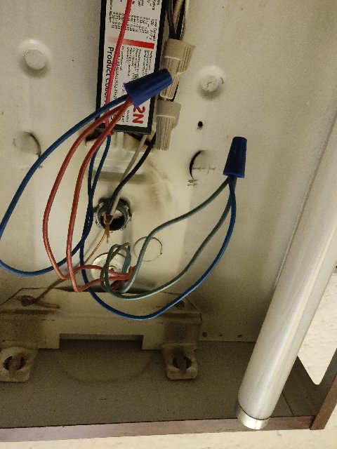

Post a picture of the box, or link to product as well as a picture of the guts of the fixture. I can tell you exactly how to do it with that information.
Team Apathy
I’m pretty sure these are them. The only apparent difference is mine are a different color temp and a box of 16.
4 Pack 32W Equivalent Bright White T8 LED Tube Light Bulb Bright White (4,000 K) https://www.amazon.com/dp/B07B..._api_i_Un.IEbF8TXPR8
Fixture pictures forthcoming....
Link to pictures of the fixture guts:
https://imgur.com/a/6Qa4eWg
This message has been edited. Last edited by: thumperfbc,
Posts: 6736 | Location: Modesto, CA | Registered: January 27, 2005Reply With QuoteReport This Post
Not a huge fan of utilitech branded stuff, but pretty easy to rewire.
You will need to replace the ballasts. Replacement ballast.
To rewire. Cut two yellow wires, splice both together with red wire from replacement ballast. Then cut both blue wires, splice with one blue from new ballast. Next cut both red wires from old ballast and splice with second blue wire from new ballast.
Ballast in my pic is different brand than link, but I prefer advance ballasts over others, and wiring is the same either way.
Wire nuts in my pics are Ideal 30-072, but you can use any smallish ones you want. Save and reuse screw from old ballast that secures ballast in place.
I do this for a living, takes under 10 min for each location, you should be able to do it under 15 min per location. Wire size is 18awg, make sure you have strippers that can strip 18awg wire.
