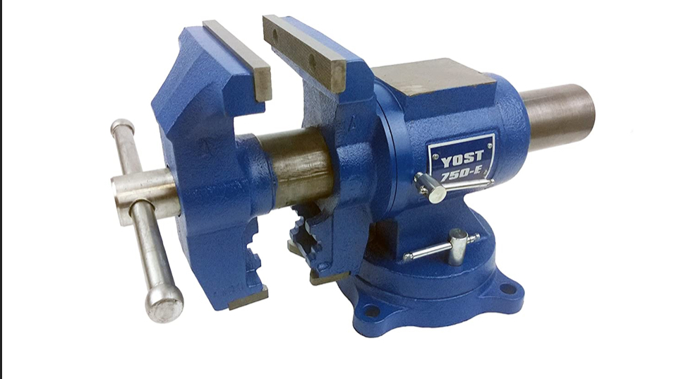

Wish I’d have gotten one of these when I bought my last one....being able to rotate the item while working on it would be great.
