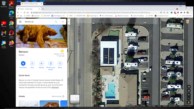

We installed Solar panels on our Resort pool. We had a large metal roofed building for the panels and had them installed on both the West and East facing sides. These were installed to, in the long term, reduce Natural Gas consumption on the pool heater. It worked great but we had to reverse flow at night in the summer to cool the water, otherwise..too hot. Eventually we shut the panels down in the summer. I no longer have the documents for what we were spending for our winter gas consumption, but I do know we saved quite a bit of money.
8 panels.
